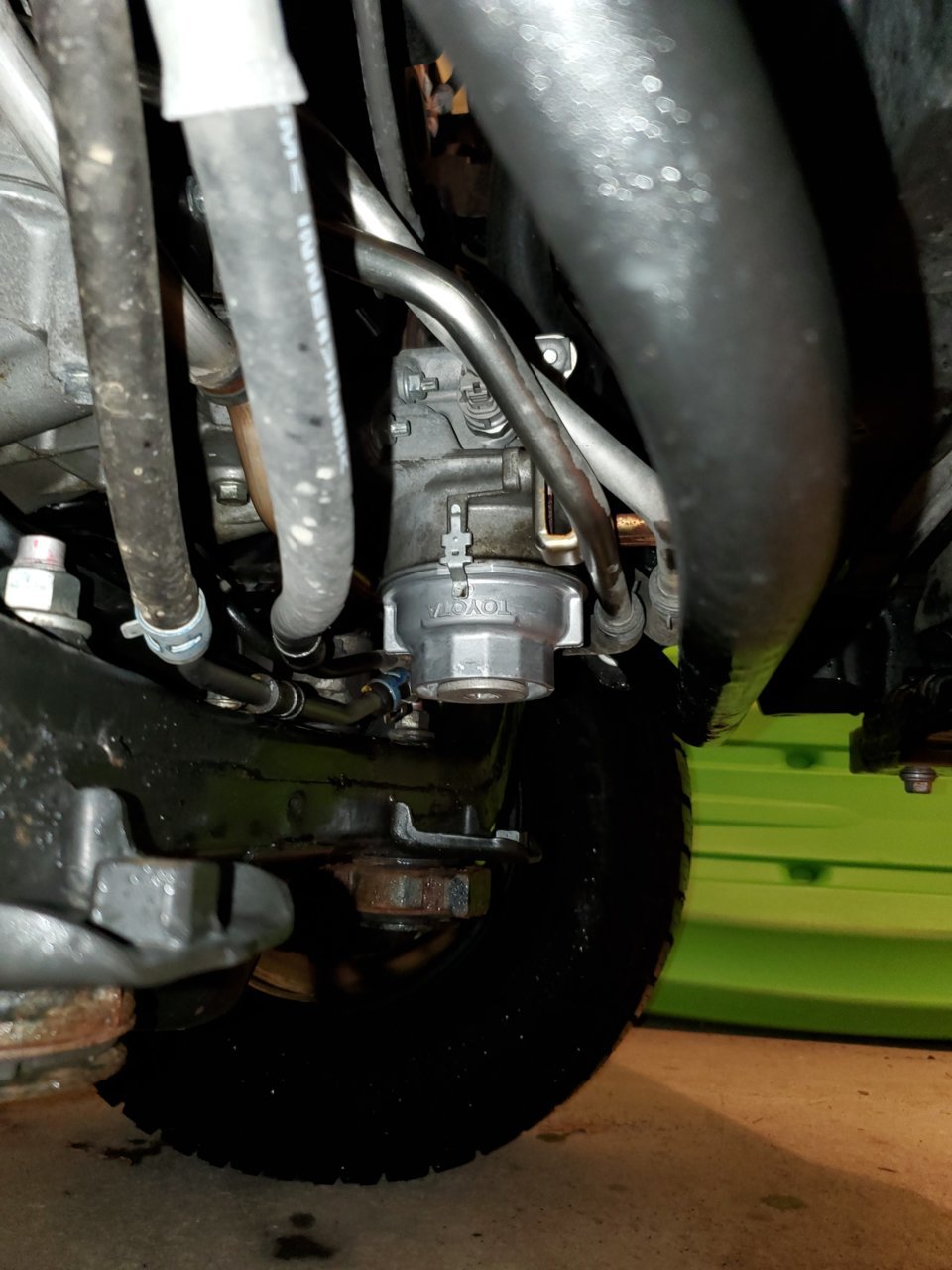

    @dylantran97 make sure the retaining clip is bent outwards enough so it doesn't catch on the filter housing. You can see it in my picture above the "toyota", I'm pretty sure its on the passenger side.20191229_164950.jpg

    Ok I definitely see the retaining clip, appreciate the heads up. Bending it out of the way is just to not damage it, not to make it any easier to loosen, correct?

    It's intended design as far as I know is to keep the filter from loosening if it isn't torqued properly. It will catch on the "wings" of the filter housing and prevent it from turning further.
    Bending it could help it loosen easier if it is catching the housing, then simply bend it back when you reinstall the filter.
