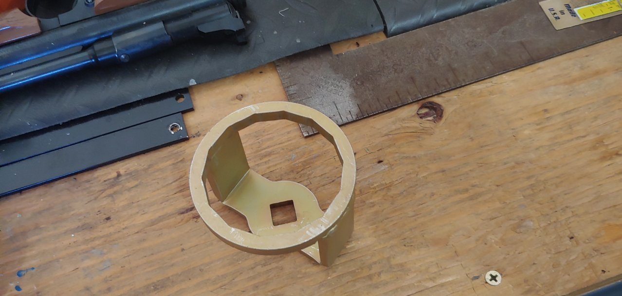

    I’m having this issue myself this evening. I bought a cheap $10 socket that is designed just for this. It broke 2 of the little plastic tabs on the filter housing (so far). I see a much higher quality socket online, (looks machined) I’m going to order that, though this won’t help me tonight. Think I’m going to do oil changes myself from now on, I assume the dealer over-torqued it. Wish me luck…

    First, this may be a long post, I apologize. So, this may draw some ire from the purists, but, whatever works! I tried the breaker bar. I think I bought a (2) inferior socket. It is basically molded sheet metal. Whenever I’d apply torque, the socket would push away from the nut (filter housing) and it would slip.
    I borrowed an impact wrench, but, my compressor does 2.6 CFM, so it wouldn’t budge.
    I considered trying channel locks, but I hesitated, as I didn’t want to negate the possibility of enlisting professional help by destroying the socket integrity (I had already bought a replacement housing, based on how this was all going).
    Ultimately, after two days and much frustration, channel locks removed the oil filter housing like slicing through warm butter.
    I’ve heard that the dealer may have over-torqued the housing, I’ve heard that this is just a flaw in the design. Either way, buy yourself a spare housing ($60 +\—) just in case. Don’t take a day off work. Just clamp those channel locks around the 14-sided ‘nut’ and be done with it. truth be told, I think my old housing is still serviceable, and I’ll hang onto it just because.
    I would say save channel locks for a last resort. I’d also say that after HOURS of frustration, channel locks removed the oil filter housing with one easy turn.

    Since the dealer was going to take over a week to change my oil, I decided to do it myself for the first time. My filter housing was stuck and this thread was helpful.
    The best advice is to use the socket on the special tool to loosen a stuck housing. I started with the 3/8 extension in the tool and it cracked the tool using a cheater bar. I put a socket on the tool - after it was cracked - and the filter housing came right off.
    Difference was night and day.
