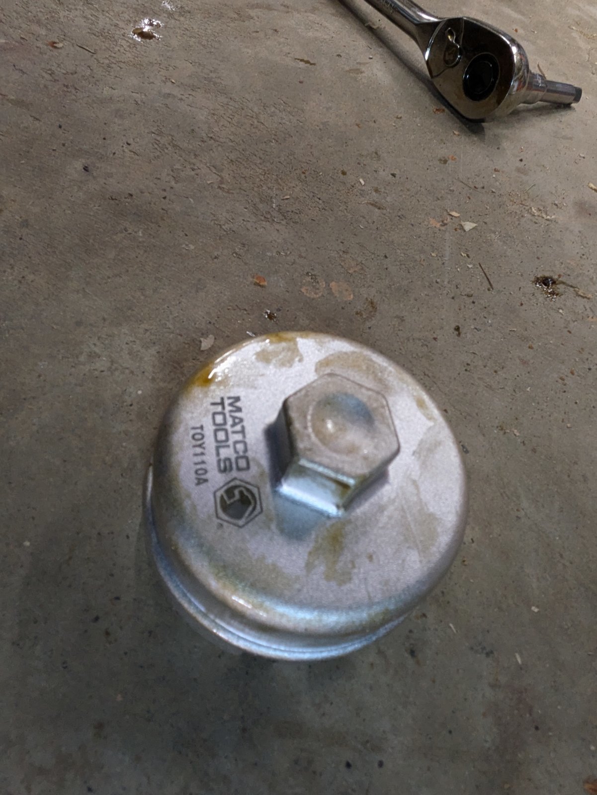

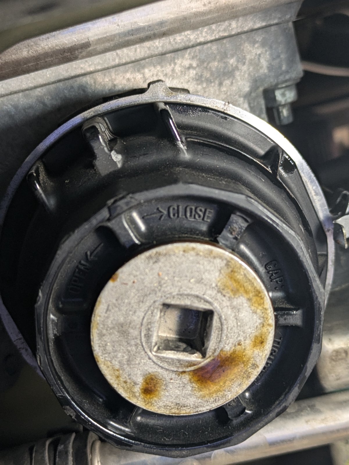

    Why isn't the filter housing socket working??? I bought it at the dealership. The teeth don't mate up with the housing you can see I slightly damaged the teeth on the housing. What am I doing wrong?

    That's the problem. Engine is 6 cylinder.

    i looked a little more after posting and confirmed 4 cyl at matco site (fixed post). i still don't know if if is different
    from 6 cyl. but something worth resolving. could be they are different. i only know my 6 cyl.

    mine has the slots on the side to...so it cant slip unless the tabs break.

    I am not 100% positive but fairly sure the housings are the same size for 4, & 6 cyl. It is the filter and guts in the housing that are different. I think the housing is over-tightened in the current case. You can try a standard 65mm Toyota oil filter socket with 14 flutes.
    Note: I be wrong. The 6 & 8 cyl use the same housing. 4 cyl is different. Dimensionally, the two Matco sockets look the same. The 6/8 cyl version adds the flutes.

    if it puts pressure on the tabs thats what causes the housing to crack

    Yes, a spin-on. I was referring to the 4-cyl housing wrench that the OP purchased. He got the one that some 4-cyl engines in sedans use.

    They for sure are. Last time they did an oil change they had to use a breaker bar to get the damn housing off. Can't even trust dealerships to do basic shit anymore .

    The OP has the wrong cap wrench. Get the motivX one or the correct one from Toyota.

    what the dealership oil change guys don't understand, when the O-ring is correctly installed, it is the SIDE pressure of the O-ring that seals the oil in. not bottoming out and tightening beyond the torque spec which only serves to lock up the assembly. it does nothing to keep the oil in.
    it seems the dealerships could see that the oil changers understood this, requiring only a sentence or two, before letting them loose on customers.
    the first time i changed my oil after toyota "care" it was difficult to loosen, like so many others here.

    most techs, 'kwik loob' and dealer greasers, don't add oil to the o-rings. i have minimal problems removing the plastic housing once the o-rings are properly oiled.

    Email matco, maybe they sent you the wrong one
