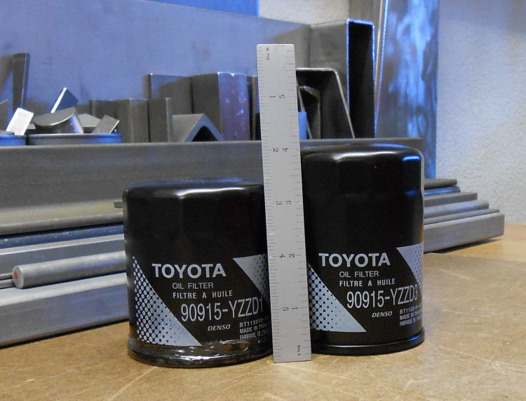

    Yes.
    It's also worth noting 90915-YZZG1 and 90915-YZZD3 filters are interchangeable, with the 90915-YZZD3 offering a slightly higher capacity.

    The D3 rubs my 3.4 oil cooler (OEM) lines.
    2oz difference tops between D1 and D3.
