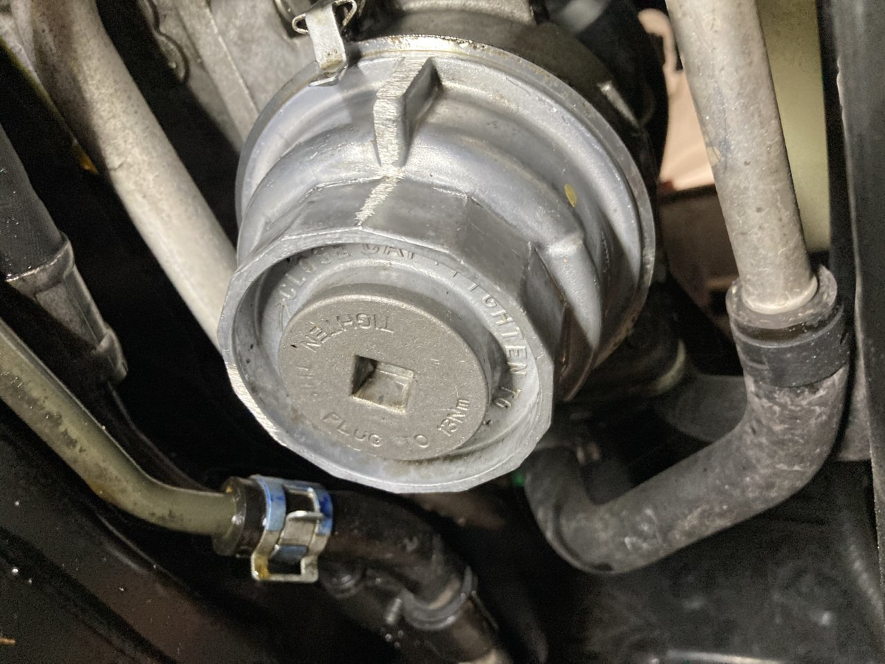

    Here's some close-up photos I took after removing the access panel.

    Completely off the wall, but this actually happened to me about two months ago; I experienced a leak due to a micro-crack in the oil filter drain 3/8 drive circle piece pictured above. No idea how it happened, but I couldn't even see any cracks. It took me getting under the truck and watching where the leak/drop was accumulating while the engine was on. It wouldn't leak until pressurized and up to heat, so it was hard to replicate at first. Ended up just buying another housing and using the new 3/8 drive drain plug from it. Not saying this is very likely to happen to anyone else, but it strangely happened to me, so might as well look and see.
    Edit, nevermind; after reading your post over, sounds like your leak is originating from the seal (or lack of) of the actual housing since you can see it running down the side.

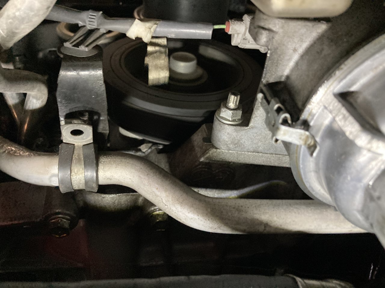

    As I said in my first post, I hate that to have something done right, you have to do it yourself! As others surmised, the tech failed to change the O-ring but I am somewhat surprised that that while it wasn't leaking before the filter change, it was streaming oil out after being re-installed.
    Picture taken while running after being warmed up - no leaks! And as I discovered, there's another reason to do these jobs yourself...Note the missing bolt!

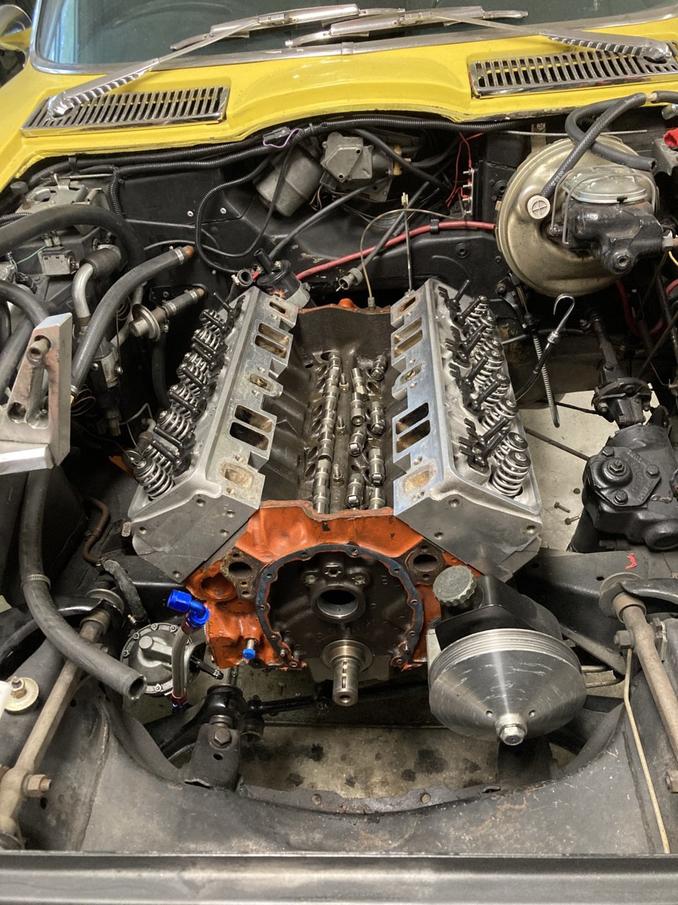

    And as I indicated earlier, I do have the skill for these tasks and more. This is my 550hp, 406sbc in my 65 vette, something I built from scratch myself and wouldn't let anyone else touch. I've owned it for over 40 years and in addition to building this motor, I have done everything on it from the wiring to the upholstery and even the paint.

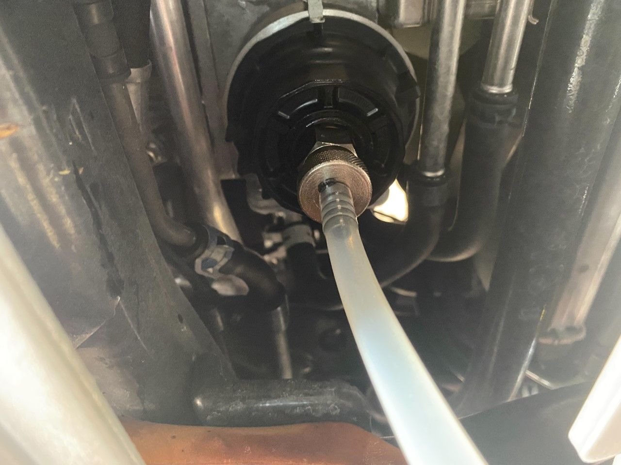

    Yeah, I've decided to do them all once again. I did the first two myself and really disliked both removing the skid plate and the mess when opening the cartridge. I've since decided to leave the skid plate off and have learned that one can drain the canister before removing it. That last bit of ignorance is on me - I've done so many oil changes in my life that I didn't figure I needed to look online for info on doing this one. Now I know how to use that plastic spigot to drain the canister first.
