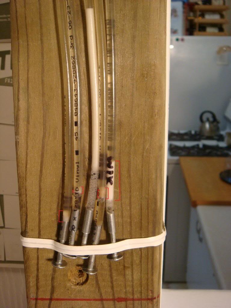

    Here are some pictures:
    Left to right: Fram orange, WIX, K&N
    These have settled for a few days. I am non-plussed by the NAPA Gold/WIX. But This does correspond to the given betas, efficiencies, in my opinion. It is a well built filter, but has never been an outstanding performer in my cleaning tests. I used Fram for the low standard.
    The Wix NG still did a bit better than the K&N.
    Left to right: PureOne, Toyota OEM (Denso), Mobil 1 E.P., WIX, K&N
    It is hard to tell from the photo, but there is a clear visual difference in the first three, and the second two. The order of cleanliness from best to worst is also left to right. The PureOne, as expected, was outstanding. The Denso and M1 were almost the same but I have to give the nod to the Denso. The Denso also flowed best of all. The WIX and K&N were a bit on the mediocre side of cleanliness but both flowed well.
    The PureOne flows twice as fast as the same models made several years ago. There must have been some concern about start-up valve rattle--but I am speculating on that. The flow charts I have seen for the PureOnes show a nice, pleasing flow curve comparing favorably to other popular filters. The M1 flows about 2/3 again as fast as the PureOne in my test.
    Of course, these are all at room temperature with gravity pushing the oil in.

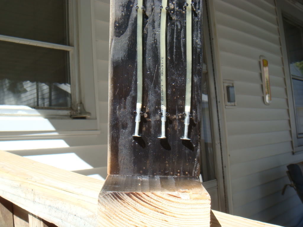

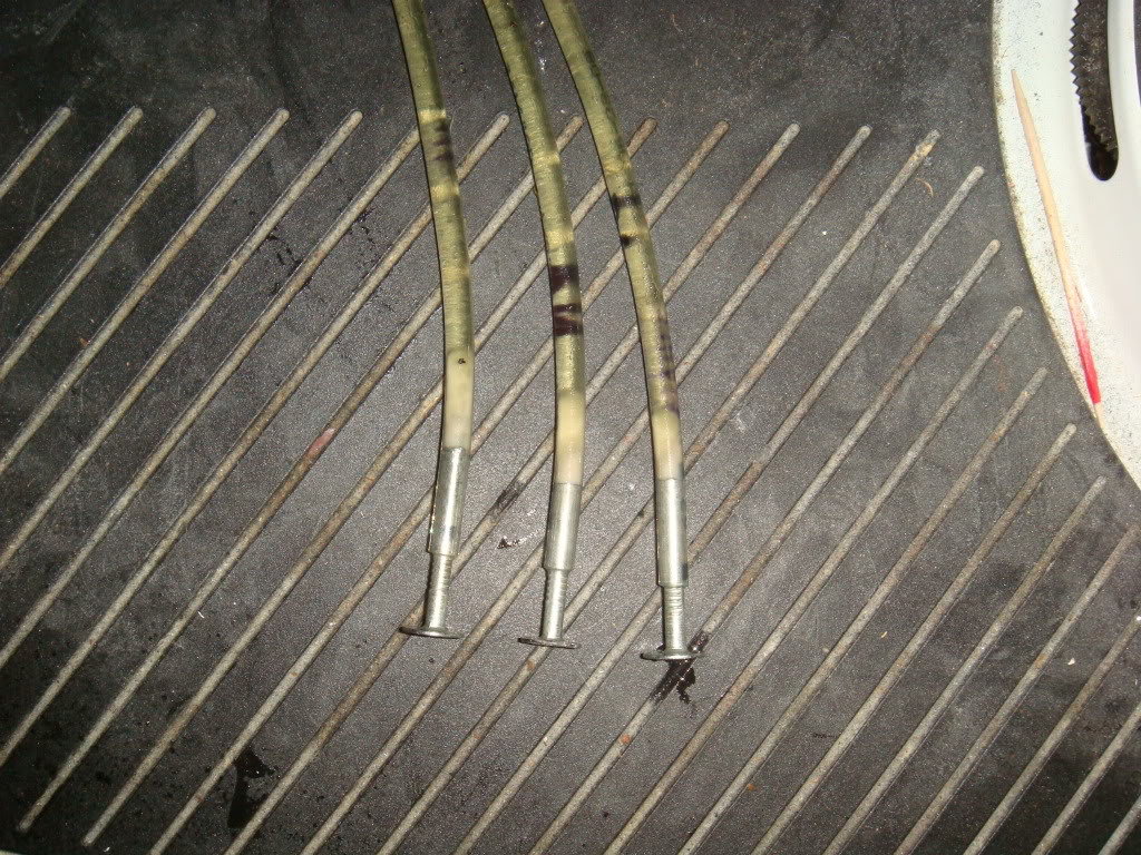

    Now that the oil is clear above the “grit stacks,” here are some more objective pictures:
    Left to right; Fram orange, WIX, K&N
    It appear the WIX does best, Fram second and then K&N.
    Left to right; Mobil 1, PureOne, K&N, Denso, and WIX
    This oil/talc concentration is stronger than in the above picture.
    Note that I attempted to bracket the tops and bottoms of the grit stacks for visibility because some of these are resting on air bubbles rather than the bottom of the tube. The results are as expected considering the relative turbidity of the oil tubes before settling out with the exception of the K&N which must have developed a media leak by the second test run. As in the picture above, it already has been tested. I don’t know what happened to the K&N as it was handled with the same care as the others. Must be a defect. (still unacceptable to leak like this)
    So there you have it. Numbers are numbers, ads are ads, and dirt is dirt when held up to the light.

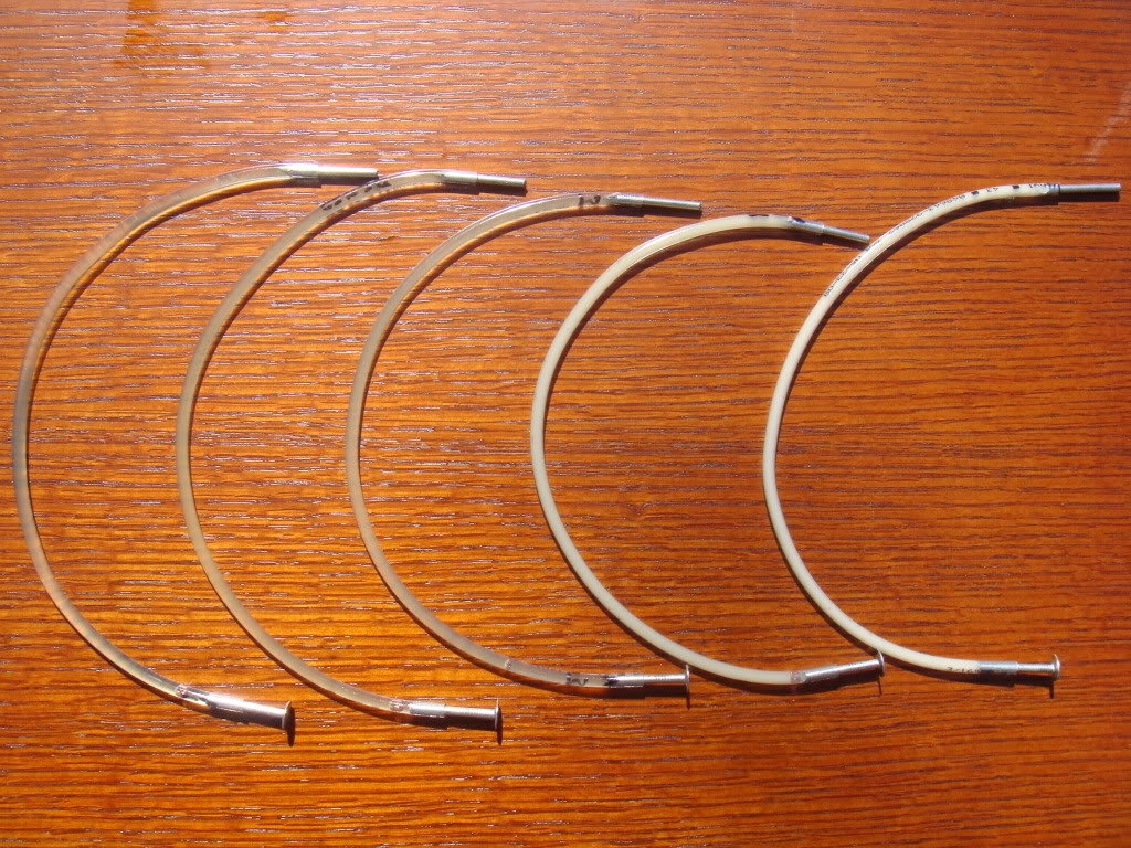

    Thought you all might want to know that the Bus size K&N oil filter, HP-2004, now I tested it three times cleaning the element with kerosene between and it's filtering as good or better than the M1, and almost as good as the PureOne every time. I think something was leaking in the first one I tested. Maybe a tear in the paper.
    L to R: PureOne, Mobil 1, K&N
