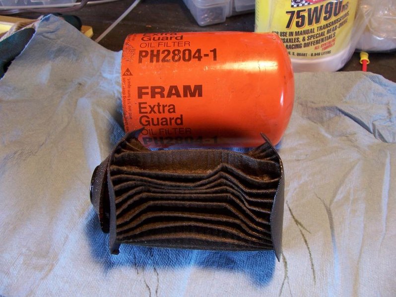

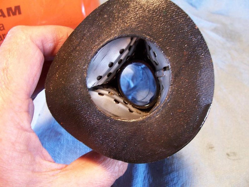

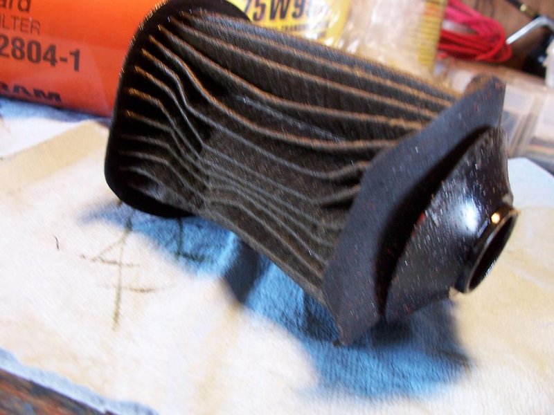

    Half way through a 20 minute run around thunderhill, I noticed a serious drop in oil pressure, it usually runs around 60 psi hot. I pulled in and checked the oil and there was plenty, just the pressure was low.
    When I got home I verified the pressure with a mechanical gauge, still low.
    Next, I pulled the pressure relief set up to see if it might be partially stuck - nope, that was fine.
    Next, I replaced the fram with a Baldwin and BINGO the oil pressure was back to normal.
    So, I pulled the filter and cut it open. It was collapsed.
    The 308 is not noted for high oil pressure and I wasn't running high revs cold, the pressure relief system moved freely, not sticky.
    I think the Baldwin sells for 12-15 bucks but it works and is a high quality filter.
    I run baldwins and synthetics in everything I care about.
    Check with a local dealer to see what they recommend for your local climate, then adjust for how hard you push the engine.
