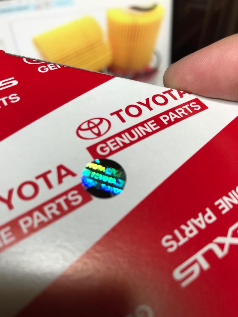

    So I changed my oil on my own for the first time (on the Tacoma, I’ve been changing my own oil for 25 years and never had a problem like this).
    New oil filter & o-ring but the thing is dripping oil, more than one drop per second. Pulled it off, looked for cracks, made damn sure all was clean, put it back, torqued correctly, same result.
    What in the world is going on? In 25 years and multiple vehicles, I have never experienced this.

    Is the oring on the correct landing?

    Install both o-rings in the correct location?
    Over torque and cracked the plastic houseing?

  5. Jul 23, 2019 at 6:31 PM
    Bootstrap
    Bootstrap [OP] Well-Known Member
    Oct 23, 2016
    #200479
    84
    It’s leaking in the same spot. Back most side of the truck. I could have cracked it but I looked very closely! I guess I’ll look again.
  6. Jul 23, 2019 at 6:31 PM
    Bishop84
    Bishop84 Well-Known Member
    Dec 17, 2015
    #172494
    12,021
    No, that is the correct filter.
    The only time we see oil leaks with A1's is if the oring is on the wrong landing, or the plastic housing is cracked.
    The filter box even has a picture of the landings.
    TomTwo likes this.

    It’s cracked. And on the “unscrew” side. It was extremely tight and hard to remove. Toyota changed it the last time. I’m sure I don’t have any recourse but I’m going to call and bitch regardless.
