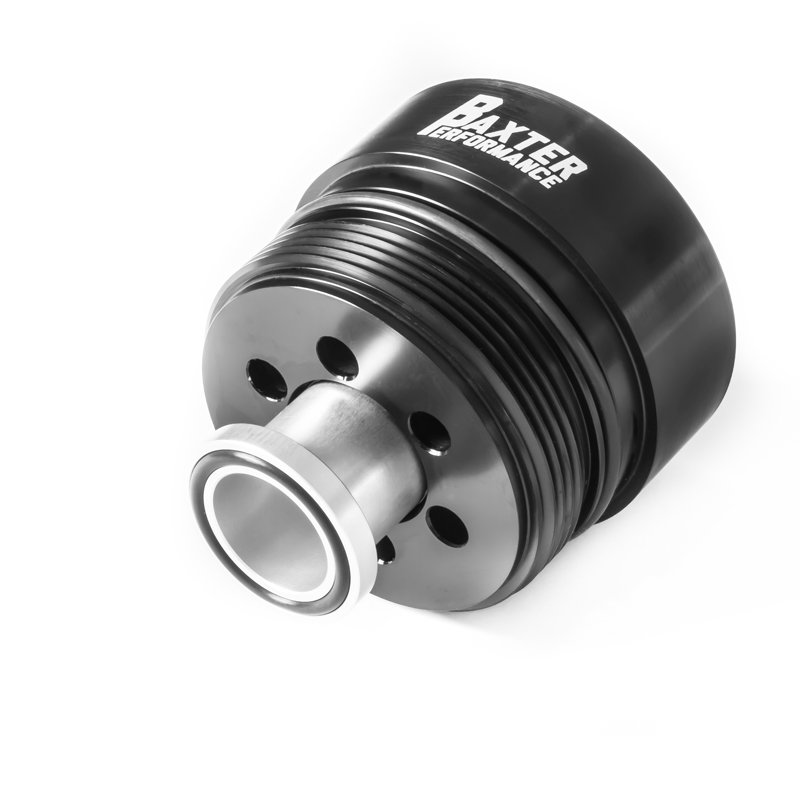

    Here is a pic

    OK, so this thing just screws onto where the cartridge housing is....!! What is the benefit..? Oil will now run down my arm when removing the spin-on filter. I get NO oil anywhere with the current system AND a fumoto valve..!!..??? OEM Toyota filters are available on e-bay and other places for cheap also..!

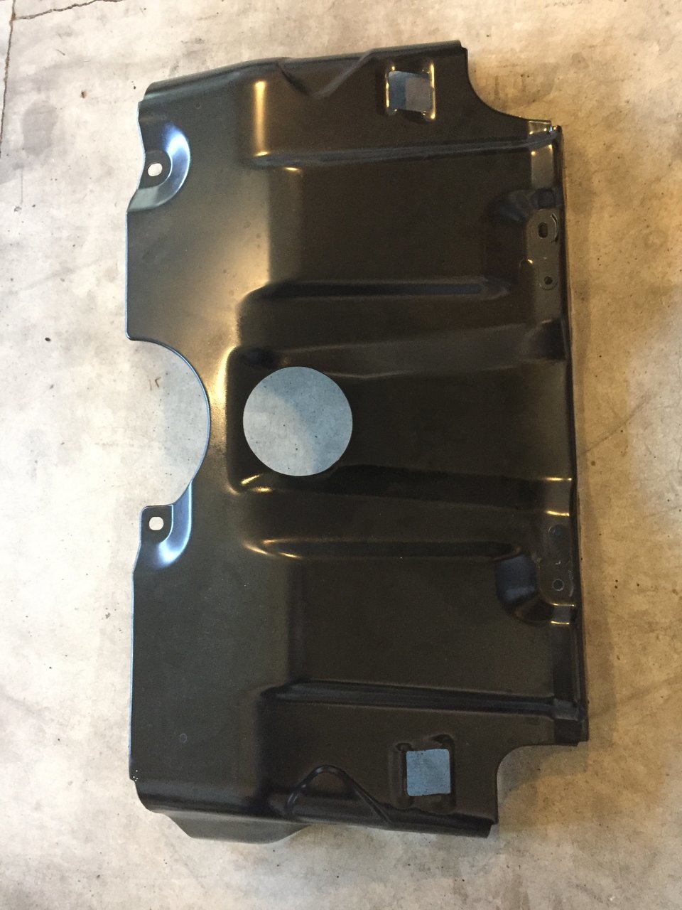

    OregontoBajaCA
    OregontoBajaCA 2025 DC OR High Bread
    Dec 6, 2017
    #237812
    849
    2025 OR DC iF Max
    C3C6CC0C-9A09-47E1-A31B-212A3E79D1FD.jpg I cut a hole in the stock pebble shield with a 4.5 inch hole saw a few weeks back so as to allow for easy reach to the stock filter housing and draining of oil with a clear vinyl tube prior to removing. Some rustoleum was sprayed on the bare metal edge.
    For those on a budget and desiring a slightly stronger front skid, you could purchase a second stock skid plate for a few bucks and possibly spoon it with the original for a double wall skid, sealing the space around the hole opening with some silicone.
    The plan for now is to just install another piece of larger diameter metal over the hole held into place with one bolt allowing it to swing away to open the hole. It could be cushioned with some dried silicone around the edge to keep possible rattles at bay but I think a thicker piece of aluminum or sheet steel over the hole would be solid enough. Two bolts could be used. Just another small project to finish.
    I’m thinking about ordering a set of aluminum skids for the Tacoma. I have a set of aluminum skids that I’m going to sell taking up space in the garage from the last truck.
