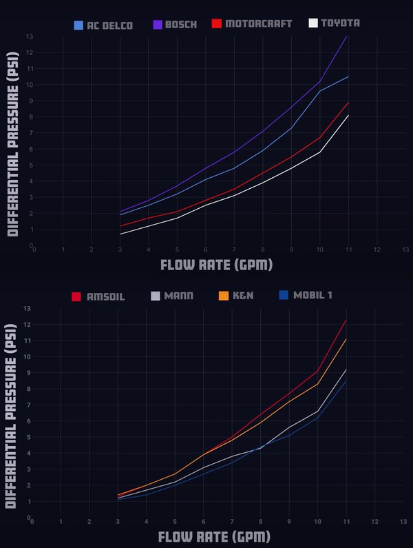

    At operating temperature, the Toyota filter causes 5.8 psi drop at 10 gpm, while the Amsoil filter causes 9.1 psi drop at 10 gpm:

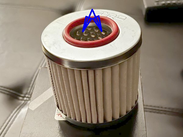

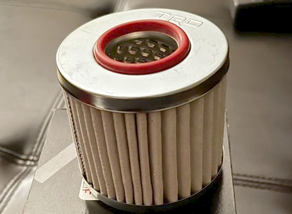

    The above are tests of canister filters, so they are a test of the filter media, with the conclusion the Amsoil media is more restrictive than the Toyota media. In the case of cartridge filters, the Amsoil filter has an extra steel center tube with tiny slits. This center tube overlaps with the existing one in your filter housing to create even more egregious restriction:

    oil psi drop? Restrictive filters spike oil pressure. :confused:

    ^"Pressure drop" is simply a way of quantifying fluid flow restriction i.e. they have pressure gauges before and after the filter in the test loop. The pressure gauge after the filter will read lower than the one before the filter. In the vehicle, the oil pressure will spike; more restrictive filter will cause the bypass valve in the filter housing to open earlier, letting unfiltered oil through.

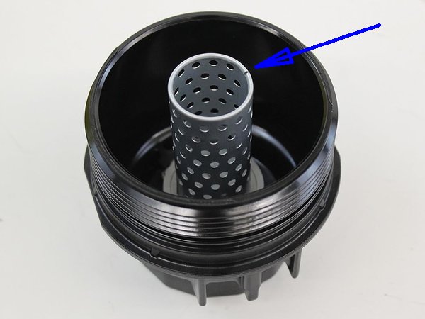

    But poorly designed. The oil filter housing already has a steel center tube:
    Because Amsoil's synthetic media will collapse without support, there's an extra center tube that slips over the one in the filter housing:
    You can imagine a scenario where the two steel tubes overlap by dumb luck to completely block all the holes.
