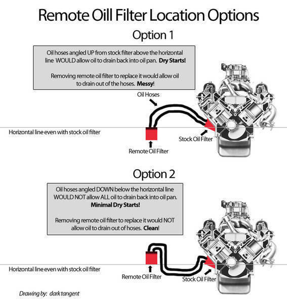

    So my next question: At what angle should I mount the filter and hoses?
    The stock angle of the filter on the block is about a 45 degree downward, which makes a mess when you unscrew the filter due to the oil draining out.
    I'm thinking that the hoses should angle downward and below the stock filter location so all the oil doesn't drain back in the oil pan. There would still be oil in the hoses and filter for Option 2.
    See my drawing, I'm thinking Option 2 might be best. Any suggestions?

    You can!! you just need a timer to keep the engine from starting before the pump is on and pumping pressure. soon as the timer is up pump off engine start. Its used in older aircraft engines.

    Does matter which ..you need a anti drain back in the the line that will solve your dry start problem. You could use a pressure switch inline at the engine. When engine starts it opens( do to pressure) and engine off ( no pressure) it closes keeping the oil from draining back.
    Im planning on doing this in the future why i have done all the research before hand. :D:D
    Im also doing a remote oil change also.which is less mess. and no getting on the ground anymore. Also used in aircraft and in marine also.

    My anti drain back valve is called gravity. I'm pretty sure that will work well for this particular make and model truck. :rolleyes:

    Hey you guys with 3.4s and oil spilling everywhere!!!
    Before changing your oil just stab the top of the filter with a screwdriver/ice pick and the oil will drain back into the block.
    Then drain the pan, and the oil from the filter will mostly come with it.
    Works all of the time, 60% of the time.

    That's a good trick. You all are providing some great alternatives to a remote filter, and now have me second guessing my purchase. It's shocking to me that not too many of us have installed one of these.
