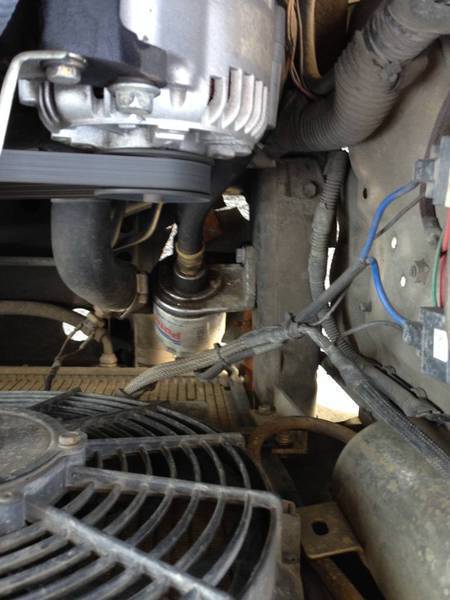

    Northridge

    It should fit fine on the frame rail. While still having the skid plate. If I remember I'll take a pic after work tonight

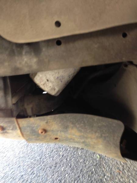

    I've used napa brand, fram, and lately I've been using Purolator. They all fit fine, but I did cut a slit in my skid plate and angled the filter so I don't have to take off my skid. As for brand I don't remember But I did get it from advanced auto parts online.
