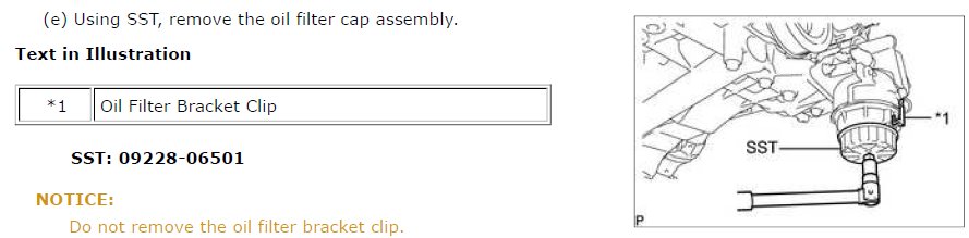

    Just to circle back this to what is in the Service Manual.
    Myself given the design for the clip, I cannot see how it would stop the cap from spinning if it already managed to loosen itself.

    It depends. If you use the Toyota tool as pictured in the SM, it only engages the flats on the lower portion. The tool that I bought engages both the flats and the flutes on upper portions. For that to work, I had to flex the clip pretty good.
