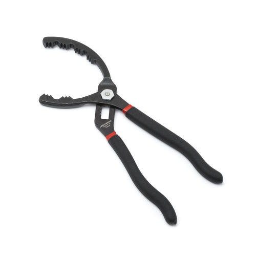

    I usually just use my hands but out of various oil filter removal tools I've collected over the years, this type of tool is usually my go-to if there's room for it. Works everytime.

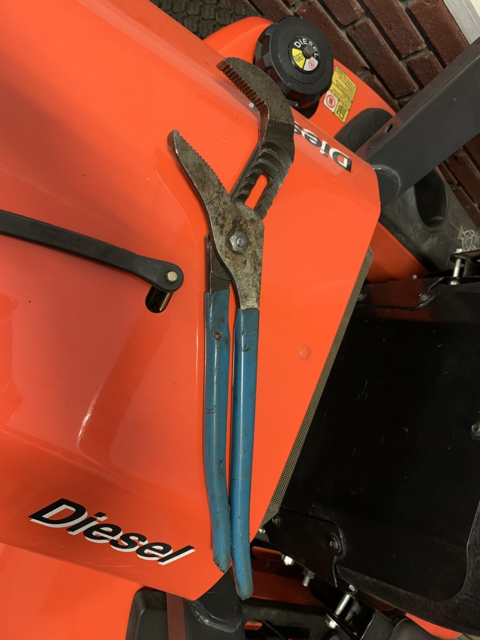

    I've never had a filter that this couldn't get loose:
    That's once I actually had that tool, of course. Before then I'd take the long-screwdriver-through-the-filter approach if something was really stuck.
