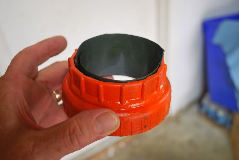

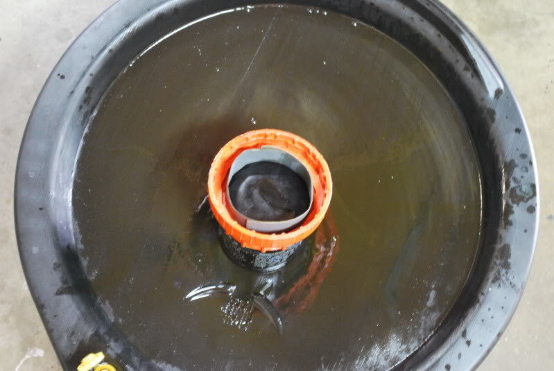

    We think alike!! And my friends think I an crazy to spend an extra $2 for a K&N Filter. Beats 30 min trying to take out the old one.
    I am not too keen on using the old screwdriver through the filter trick If you cannot get the filter off then you are hosed.
    I used the old fine sand paper inside the filter wrench trick. :D
    Worked for me this time. ;)
    I put in 6 QTS of Mobil 1 5W30 and a K&N. My Taco just turned 1K. I will swap the oil again at 4K and start to use Red Line my oil of choice.
