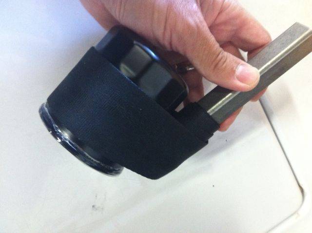

    OK, so I was changing my oil filter today.
    Using my "Old School" oil filter wrench circa 1982: Pretty much never used anything else. (OK, I'll fess up - I also used to use the "handle style" one. But that's not what's in my toolbox.
    I always used to install filters "hand tight" but the Toyota directions call for the filter to go 3/4 turn past contact, which is more than I can do with my fingers. So I ended up partially CRUSHING the new filter trying to tighten it on there.

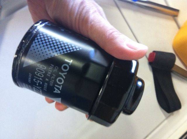

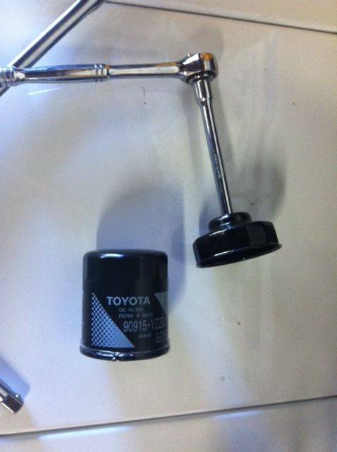

    So - I go back to the dealer to get a *SECOND* filter and LOOK: what do they have there right with the filters? What the hell is that? Does it go on there?
    And, like a socket fits in it??
    You youngsters have it so fucking good. I mean, you have *no* idea. :rolleyes: :cool:
    But, seriously, when did this newfangled style of filter wrench show up on the market?

    Is this real life? Lol. Ive been using that type for several years now. Not sure when they came out though.

    I've had one the "new fangled" filter wrenches for probably 10-15 years. I still prefer my "old school" wrench though on the Toyota. The other one worked great on my old civic where it was impossible for me to fit my hands into the tight space that filter went into.

    Since they started making the tops octagon shape I suppose.

    Those are older than you likely.
    They have been around forever but are not popular since it is not a universal size for all filters.

    ????? I used cap wrenches like that since the 70s. That's one reason I don't care for the Amsoil EAO filters... they have no flats for a cap wrench.
    When I worked at Pep Boys in '81, Fram marketed a plastic cap wrench that was a 2-sided, 4-step assembly that would fit pretty much any filter except for the smaller import filters.

    I dunno. Forever I just tightened it "hand tight" and didn't worry about it. Then like, I read the box and now "hand tight" wasn't good enough. 3/4 of a turn past contact...
    Well, turns out for me that "hand tight" is a little past half a turn, which is probably fine. But now I had the directions in my head, so I had to get to the printed number.
    Mostly this is all in good humour. But I just kinda get amazed sometimes at some simple advances in some simple tools that it wouldn't really have occurred to me could be improved. And the dang thing cost less than the filter that I wrecked - so it's not like it's expensive.

    Which was pretty much right away.
    My '67 Chevelle had a cartridge filter, '69 LeSabre a spin-on, and other than the Amsoil EAO, I have never encountered a spin-on that was not flatted.

    Maybe that's it - the auto parts stores didn't want to sell a whole bunch of different sizes - and I only noticed it now because Toyota only has to stock a handful of filter sizes and so they can keep wrenches for all of them with them on the shelf.
