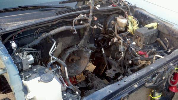

    well its not a very helpful picture or a video, but i DO have a pic of my 2.7 oil filter.. I just found it
    obviously, this is the way to change it. lol

    LOL, that's priceless!
