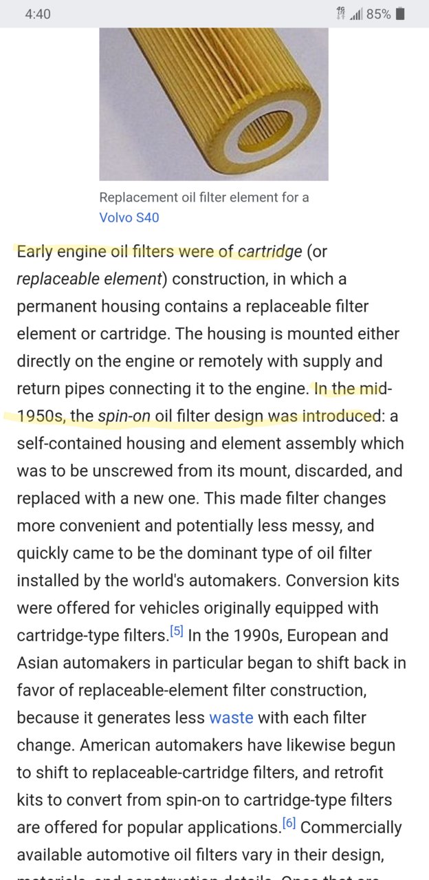

    I found this pretty interesting. Cue the, its on Wikipedia its not true, your quote isn't verbatim crowd
