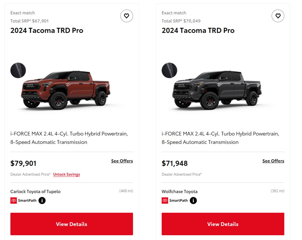

    No quibble with this argument. I was curious the price gap between a "cheap" Porsche and an expensive Tacoma.

    Agree but I'm more talking engine tolerances and sensitivity. Cylinder pressure is much less in a Tacoma lol.
    I hate 4th gen tacoma because of price, its great in every other aspect.
