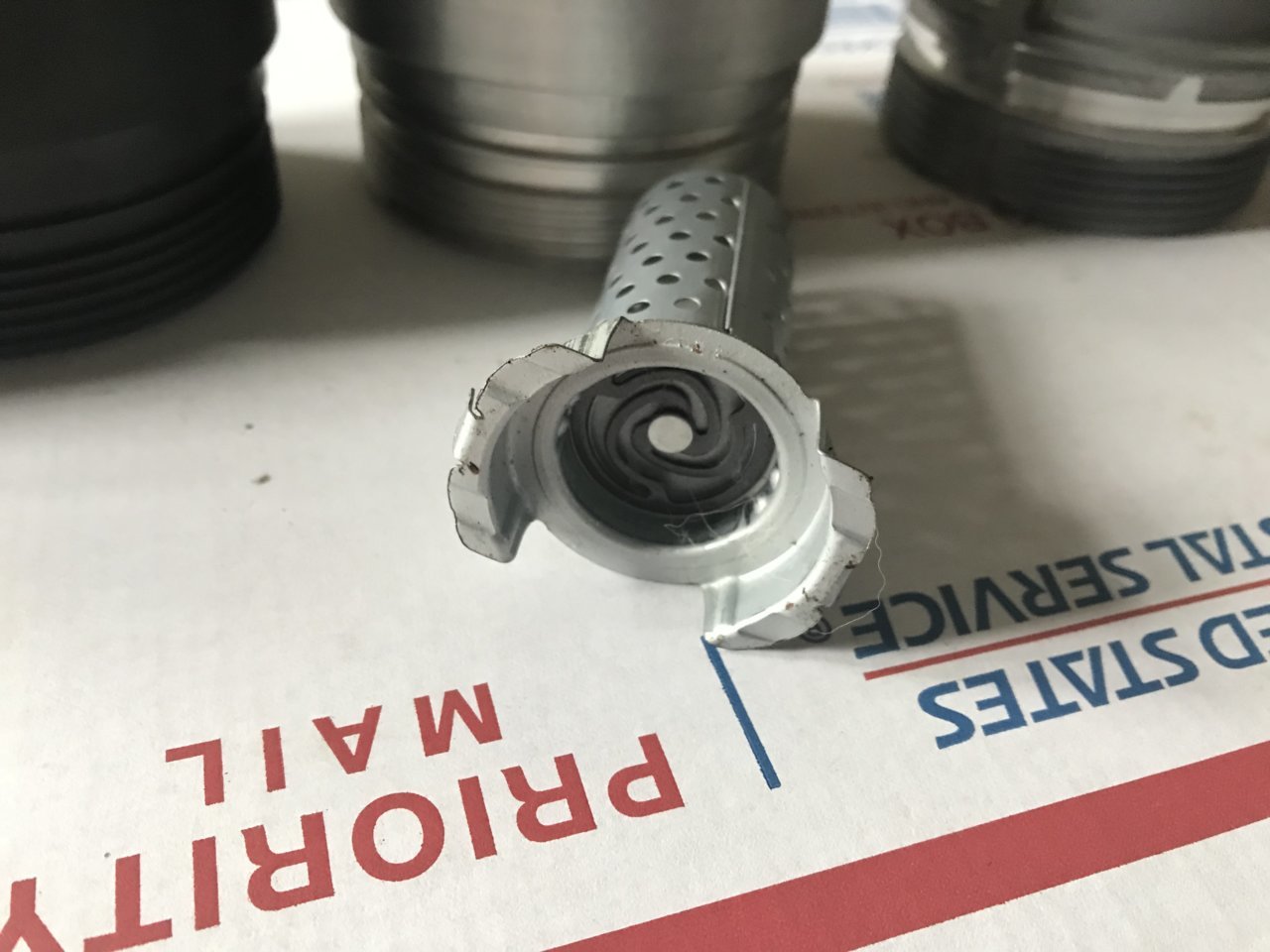

    Unfortunately the info pertaining to the cartridge oil filter bypass is incorrect. The bypass valve is located in the base below the center support tube, it IS NOT the coil spring. The spring action that allows the entire filter to move up and down allows for slight variances in filter height while keeping the filter assembly in place.

    The coil spring shown in the video is NOT the bypass valve spring.

    Nope, the bypass valve sits just above it…. The flat spiral flexure spring with the rivet in the middle.
