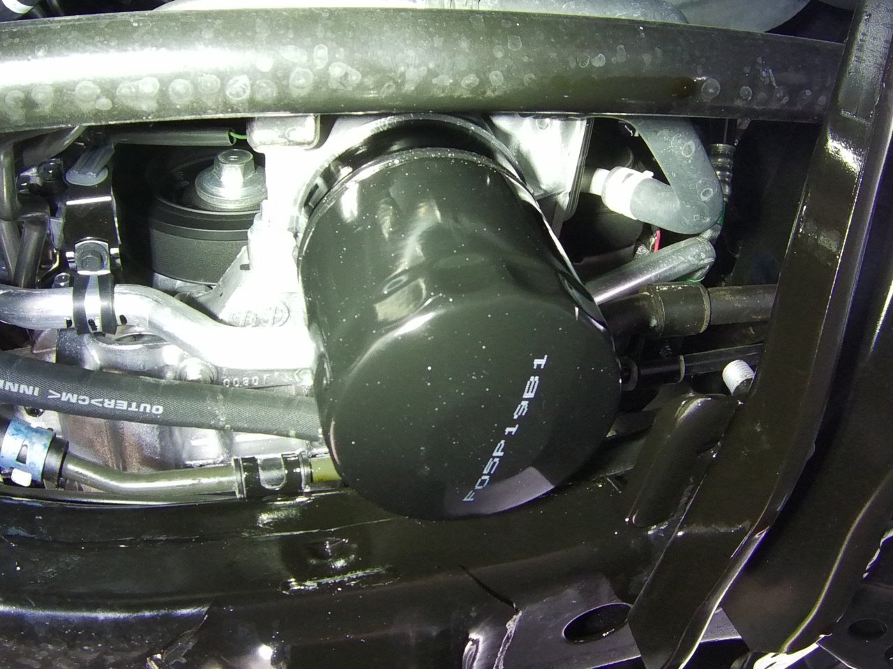

    Here it is, just did my first oil change at 974 miles and put on the Baxter adapter and a spin on filter.
    After seeing that the drain plug is not covered by the shield, I decided not to install the Fumoto valve due to the possibility of something hitting it.

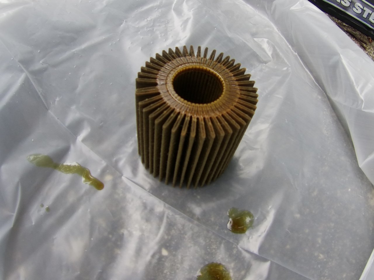

    Below is the old filter element. Doesn't look very dirty to me.

    With under 1k on a 10k OCI spec, I should hope not.

    oil change at 974 miles is only 9026 miles early, it shouldn't even be close to dirty. The drips of oil from your element in your pics still look brand new.

  18. Nov 18, 2022 at 11:13 AM
    #38
    TacoDinner
    TacoDinner [OP] Well-Known Member
    Aug 24, 2022
    #404222
    72
    @malatx,
    I just did the second oil change. The Baxter adapter did not budge when I removed the oil filter. The spin on oil filter was only hand tight.
