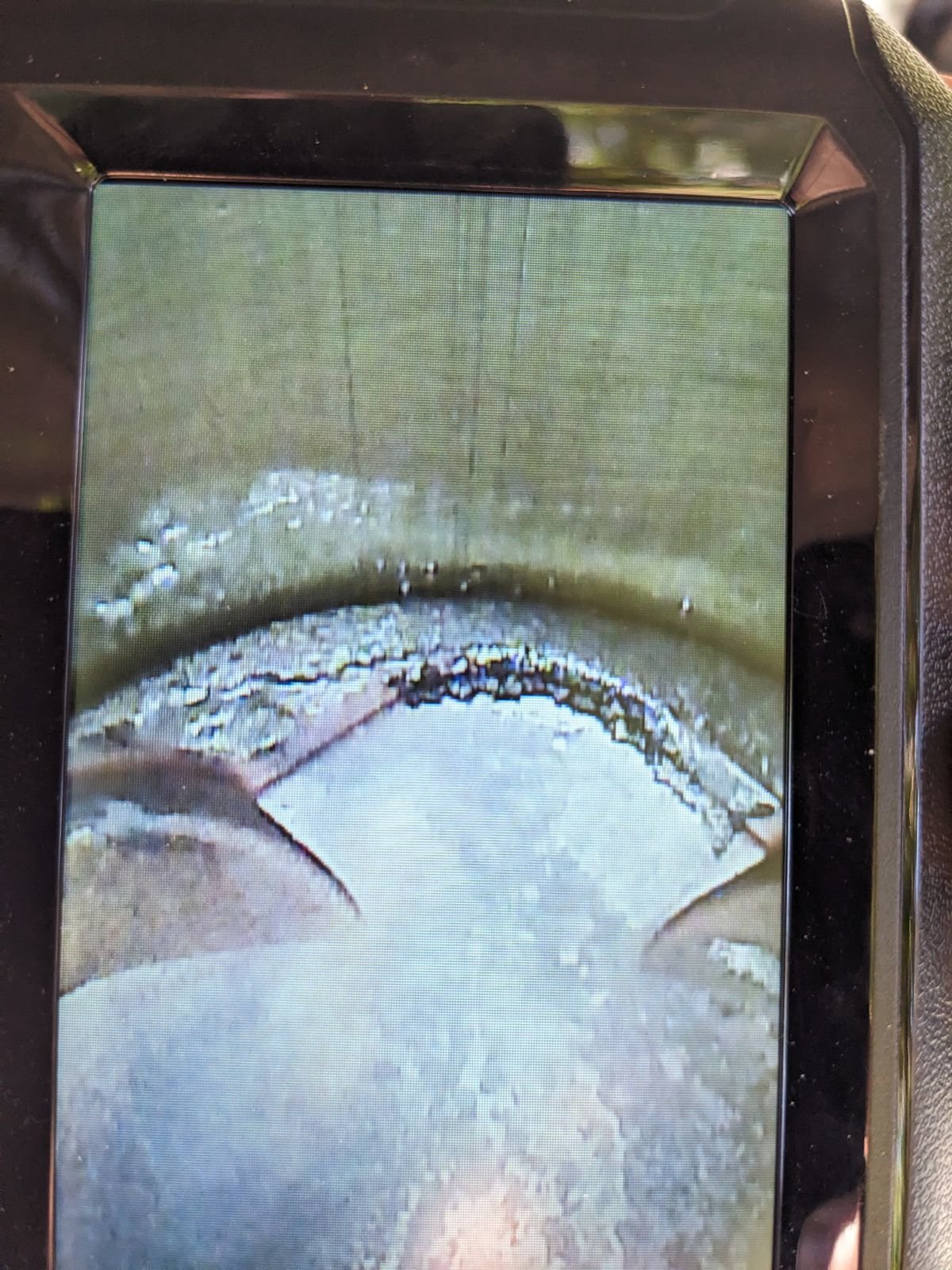

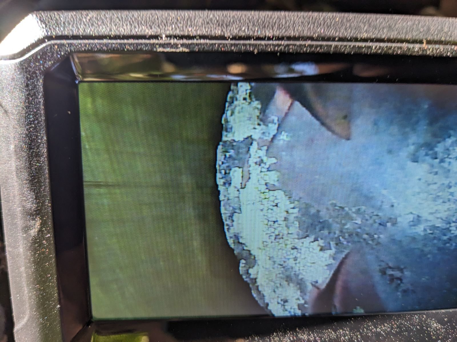

    Past week I've been hearing knocking when I start my truck and it immediately goes away withing a few seconds. Then yesterday I had a low oil light pop on so I checked the oil and was a bit low so I added 1 quart.

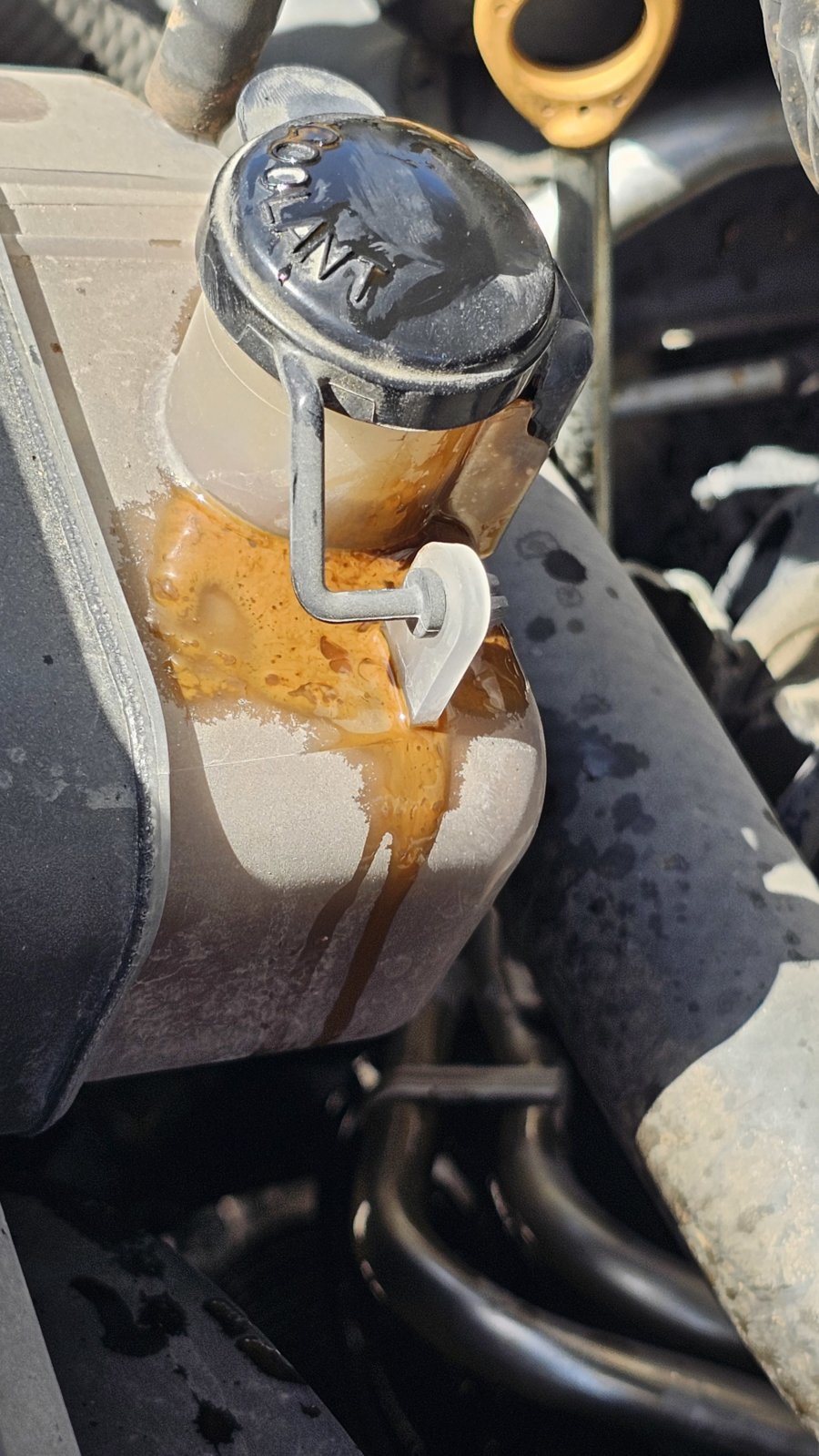

    Today I started to over heat so I pulled over and saw my coolant filled with oil. There is no coolant in my oil so far as I can tell.

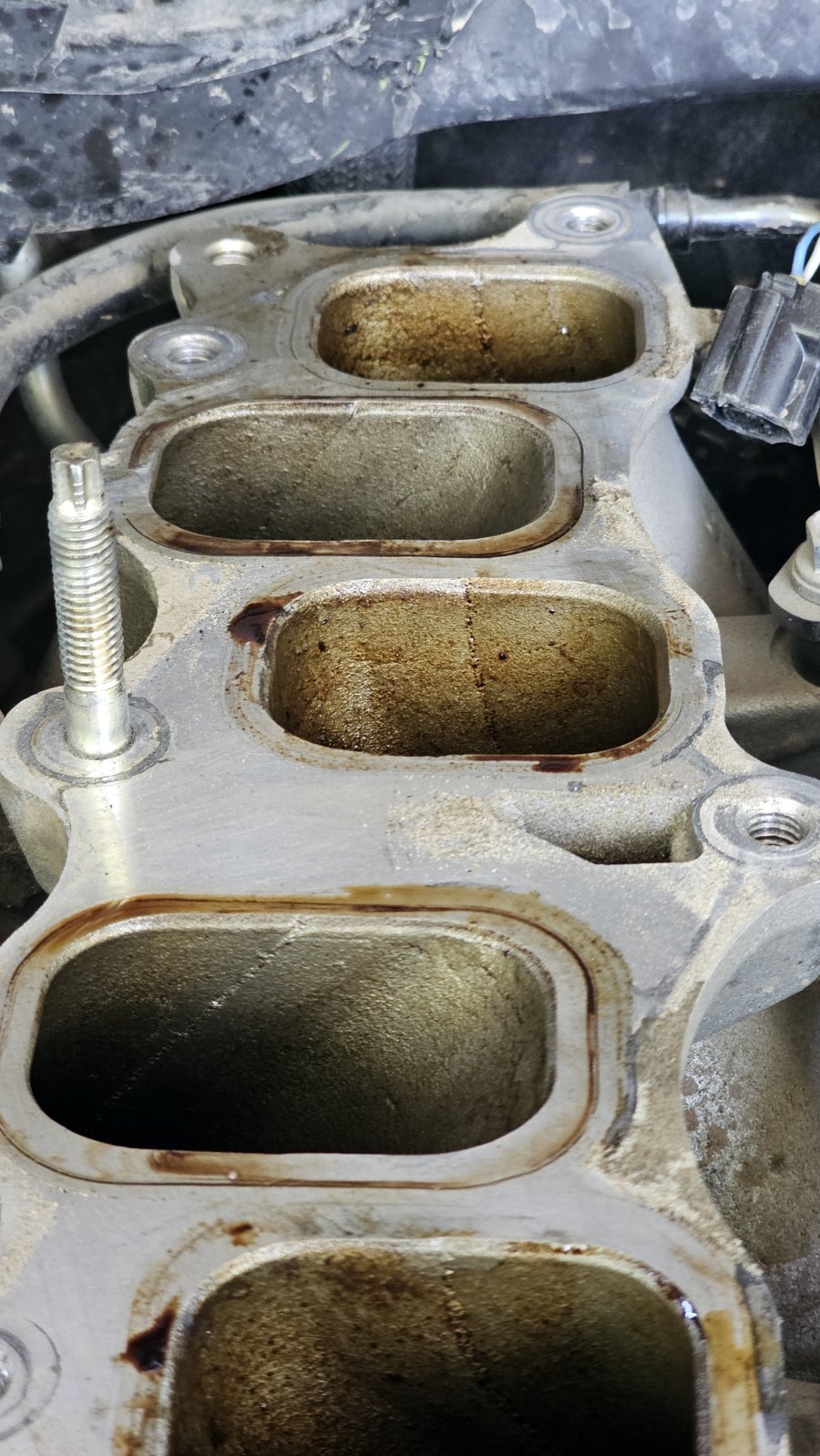

    I'm pulling apart the engine and I see sticky almost gummy residue on the driver's bank of the intake manifold.
    I had engine work done at 55k under warranty for a missfire on one of the cylinders but I'm at 100k now and they won't warranty it (even tho after they did the work my engine makes a funny vacuum noise at certain rpms).
    My question is this most likely a blown head gasket or cracked? I'll attach as many pictures as I can.
    Also when we compression tested it the driver's side all had significantly less compression compared to the passenger side.

    I'd try to run a borescope into the cylinders if you wanna know of the head's cracked or gasket compromised.

    Thank you I have a borescope so I'll give that a go we did see the cylinder walls and they looked great but we'll get deeper in there.

    You'll have to pull it apart to see what's really going on. Head gasket is easy to fix, crack not at all.

    You may also have to put a cooling system pressure tester on it to "make the leak appear"

    Also should I pull out the oil cooler? Is it possible that that's what has failed?

    I don't think it failed. You mentioned a rattle at startup, which is an indicator of the coolant in the cylinder.

    It is possible but as mentioned above, rough running tends to be a sign that the combustion process is not right.
    A failed oil cooler would only really allow mixing of the fluids, not so much a rough running condition except for *maybe* extreme situations. Especially seeing that you stated you have low compression on the left bank

    I would take a look at the oil cooler. Usually oil in the coolant comes from something else. I have seen more coolant in the oil and steam from the exhaust when you blow a head gasket. Not to say that it can’t happen, just usually see it the other way around. Also you could use a combustion tester to see if you are getting combustion gases in the cooling system.

    If the oil cooler leaks, the main symptom is oil in the coolant. This can cause many people to think that the head gasket is blown. However, a blown head gasket usually affects the engine's performance. If the oil cooler leaks, the engine will still perform normally.
