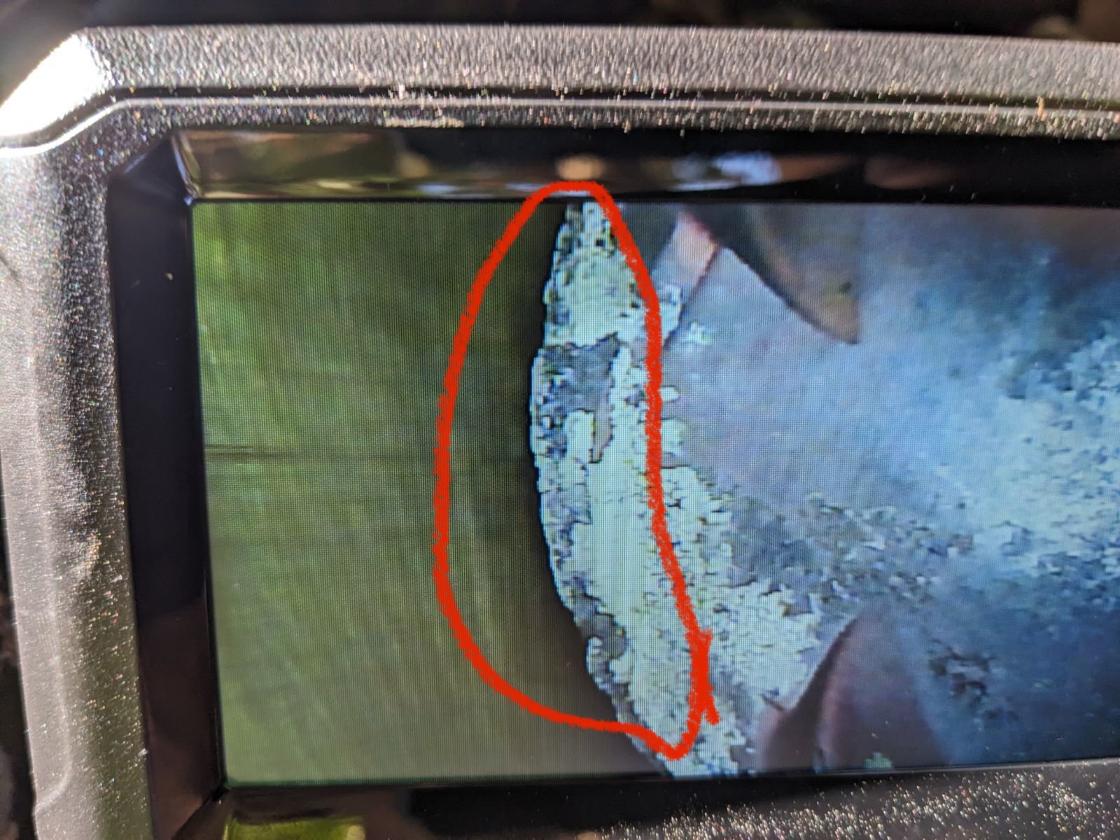

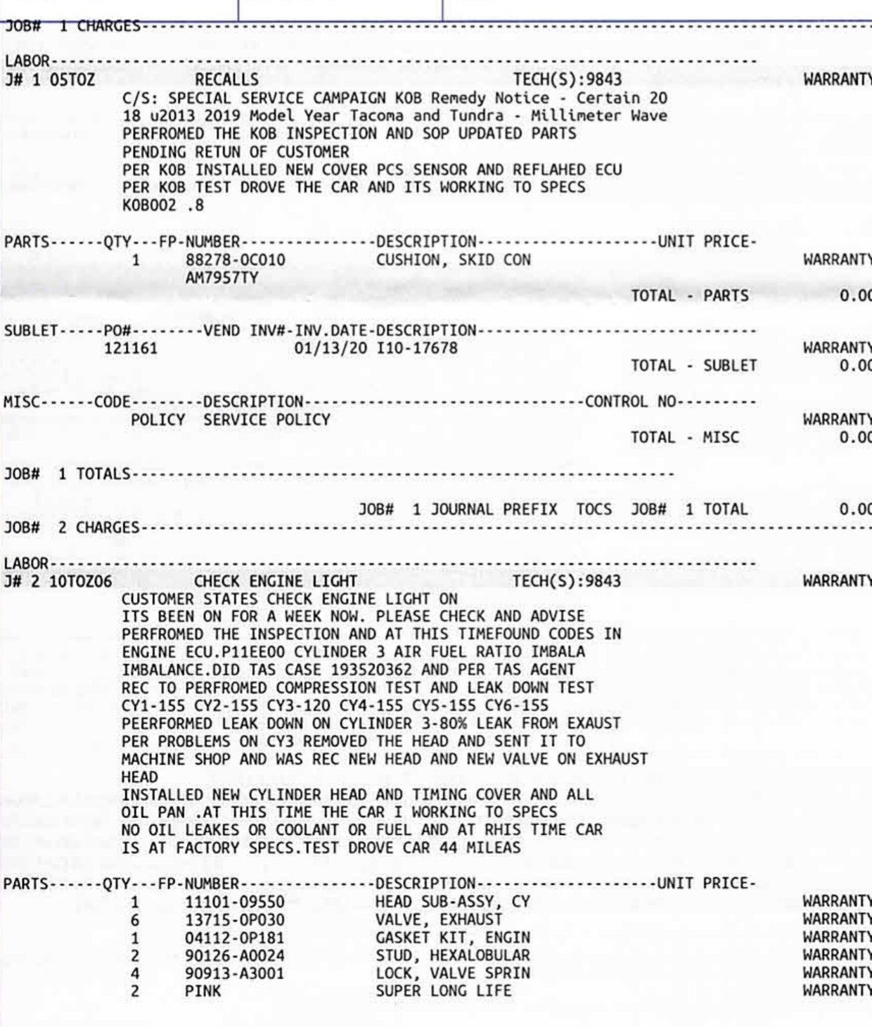

    Looks like you had a work done on bank 1 head, but you stated that the driver's side shows low compression (bank 2).
    Potentially the current issue is not related to the previous repair.
    In the cylinder wall pics, sre those scored walls?

    I believe you are correct. No the wall looks perfect with no scoring*

    My phone's resolution isn't very good, is the piston crown chewed up around the edge here?
    Otherwise a leak down test and/further disassembly is warranted i'd say.

    To me it looks chewed up around the edges with a lot of buildup on top of the cylinder

    Looks like coolant burned to the piston crown.

    That's what I was wondering, so it does look like coolant? Keep in mind I'm definitely not any type of a mechanic

    When you had the cylinder imbalance code years ago, P11EE, that was for cylinder #3. Right side middle. At that time, that cylinder was low compression, 120 psi. Now you have low compression on all 3 left side cylinders: 2, 4, 6. Probably from the coolant or head gasket or whatever happened there recently.
