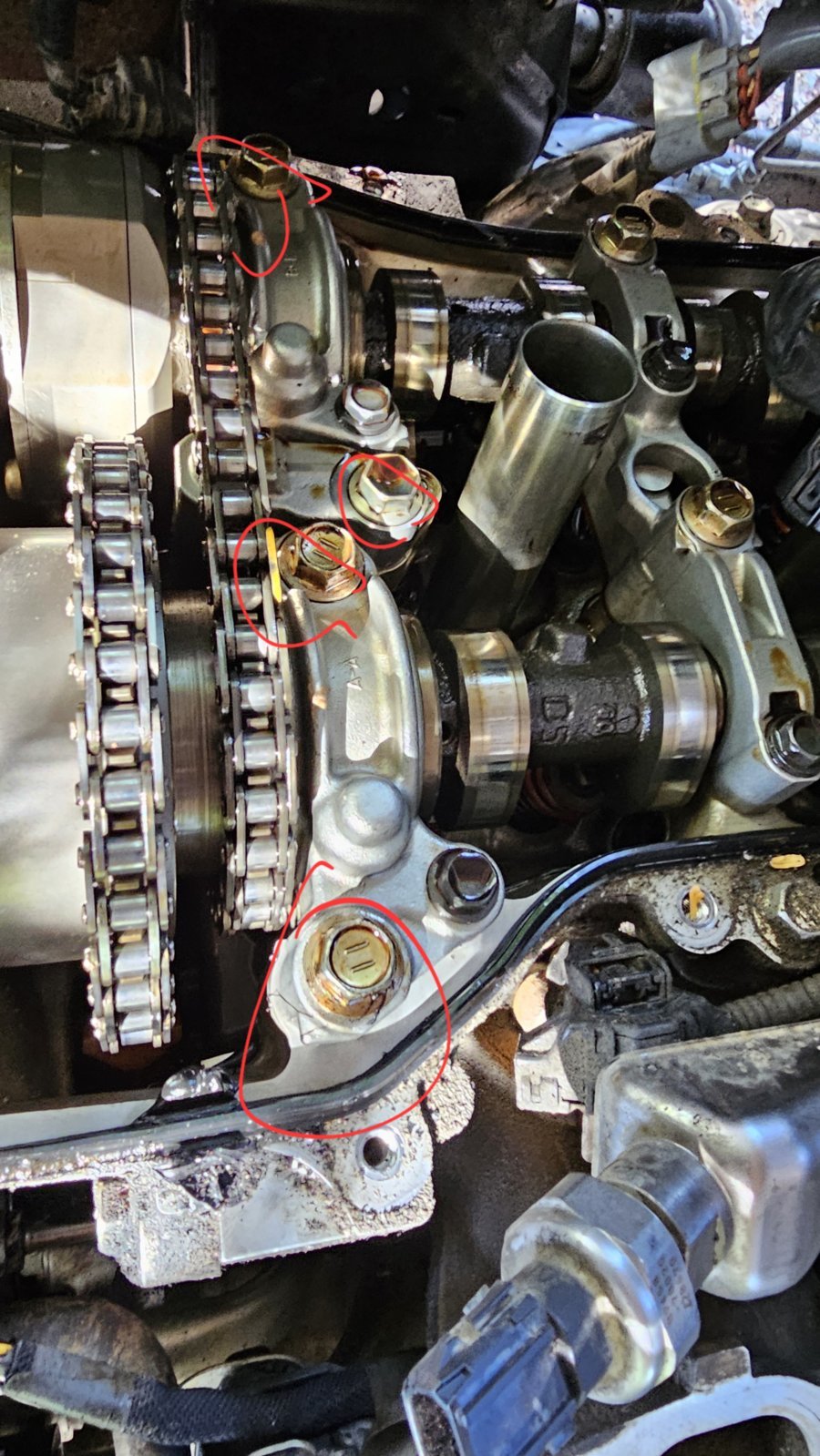

    This side they worked on 5 bolts are completely loose, 4 in the front and 1 toward the cab
  20. Jun 22, 2024 at 3:31 PM
    #60
    Vlady
    Vlady Well-Known Member
    Dec 20, 2017
    #238986
    4,617
    Issy, WA
    2017 White SR5 DCSB V6 4x4
    Those bolts hold cam tower. There is like 20-22 ft lb torque on those.
