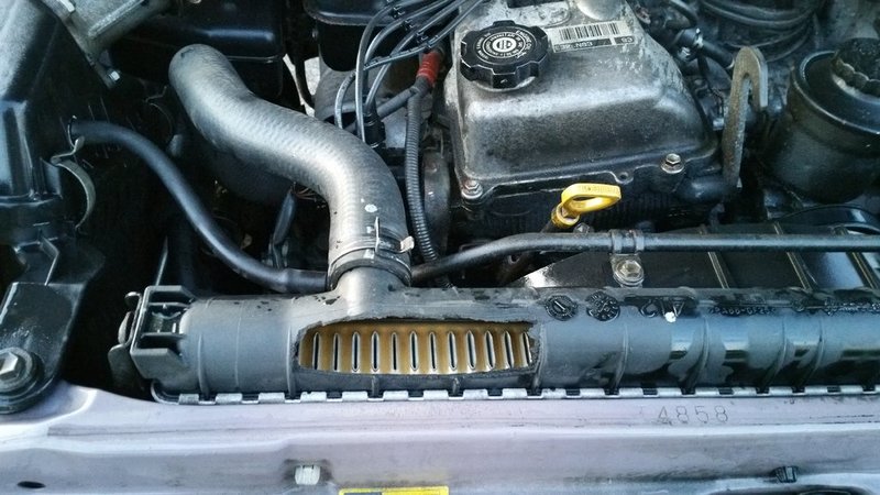

    I needed to drive the truck for a while until I fixed it, and during the next week my crackshaft bolt came loose while driving. My oil light and alternator light came on followed by my radiator blowing a hole in the top plastic reservoir. No good. I assume when the harmonic balancer came loose the water pump pulley lost tension and the coolant increased in pressure and some how blew the radiator... Alternator light came on for the same reason. This happened maybe 10 minutes into the drive, I assume right as the thermostat opened. I don't believe it overheated.

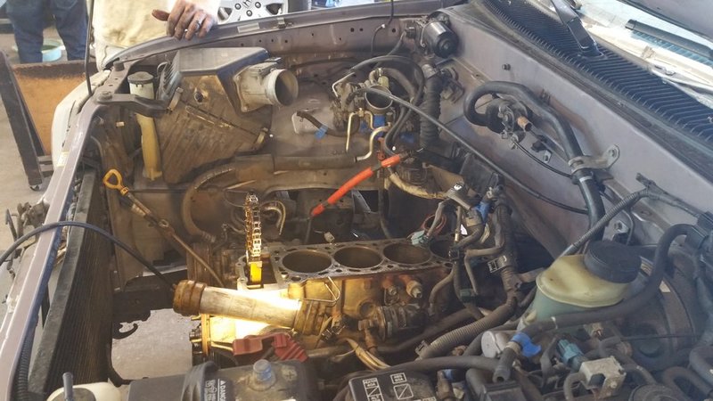

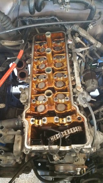

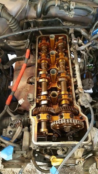

    I took this time to install a new radiator and took off the head and replaced the head gasket. It was a lot more work then I thought it would be with the camshafts needing to be removed before getting to the head bolts, and I was surprised when I got to the head gasket that there werr no glaring failures. There must have been at least a little failure somewhere with the oil leaking though. Sorry I don't have pictures of that part of the block or the old head gasket.
    The intake manifold had considerable black oily build up which I cleaned out. I was under the impression that the cylinder was burning oil due to the gasket, but now I'm unsure if it's not a piston ring... The EGR valve must have been bringing in that gunky crap into the intake.

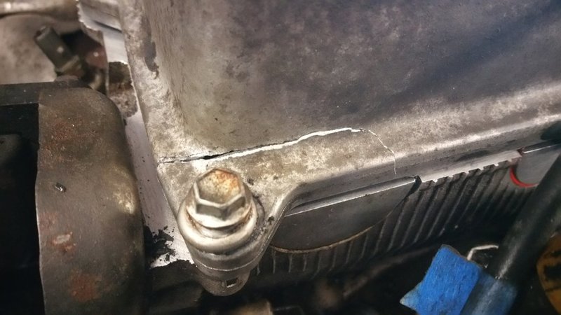

    To top it off, the valve cover was being tightened down and my manual had listed 15 foot pounds as torque (which is way too much I gather from other posts)... I sheared off the bolt closest to the corner bolt, and when that happened I cracked the corner of the valve cover. I just ordered the new valve cover it will be tightened to snug plus 90 degrees to avoid that issue again...
