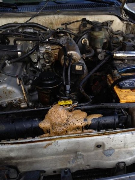

    this is what it looks like exploded out my cap on my way home from work didnt notice it till i stopped and it was dripping

    Some stuff. Not a lot, just some.
    Wow!
    Heres what it looks like when you mix the two....
    You could star over with a flush kit which you can get a walmart cheap. Flush it out good (have the heater on and it blowing). See if it returns back to the brown crap. If it does, then there is an oil leak. Are you losing oil at all?

    i dont think so i havent moved it since and last time i checked it it was a little lower than full but it's parked on a hill. i think im going to flush it like you said and see if im getting any oil then go from there.
