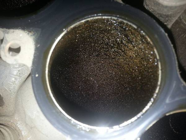

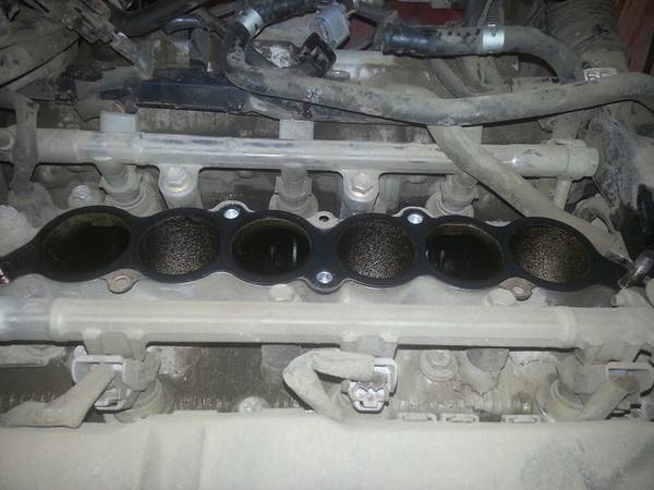

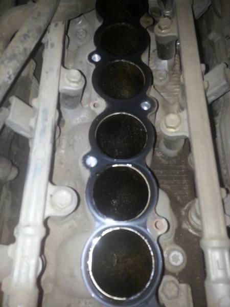

    I cleaned my throttle body and intake manifold today and I noticed a good amount of oil in the manifold and near the intake valves. Im pretty sure this isn't a normal thing. Can anyone tell me whats going on or what I need to do? Any input is helpful

    Probably just lots of miles sucking down the blow-by gases and vaporized oil coming from the PCV valve. Look upstream in the induction system in your plenum and all the way to the throttle body, and also on the front side of the throttle body. I bet they are pretty dirty too.

    I cleaned all that up today. There wasn't a whole lot but there was some. Seems the further I got into the engine, the more oil I was seeing

    This is a normal condition. PCV stands for Positive Crankcase Ventilation. The system is DESIGNED to take unburned gasses that normally get into the oil crankcase and draw them into the intake system, to be burned. This in turn does draw some oil vapor, which will deposit trace amounts on the cooler intake runners. Normal condition completely.
