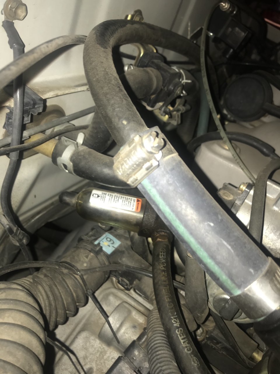

    I stand by my statement. I would love to see your throttle body to back up your statement(without you cleaning it).
    Had this truck since I drove it off the lot in '98. PVC valve is fine. It is an oil mist that will condense and coat the throttle body. The pic shows my cheap catch can (air water separator) that clearly has oil in it.
    For you all who believe this guy, google "dirty throttle body" and look at the images, throttle body fouling is due to the oil mist, not the air filter. It's a closed loop system that is designed
    to burn the oil in combustion process instead of venting to the atmosphere. EPA mandated.
    As for me personally, my heads will not be 'gunked up' and have 'catastrophic damage' due to I run water meth injection just after the TB and all that gets cleaned.
    I will be waiting for the "I told you so!" moment that you so confidently state that awaits me.

    Elnip isn't wrong. The pcv valve definitely puts out an oil mist. A catch can works to keep it out of the TB but it isn't really needed. Catch can or not you should be fine. Heck mine vent to atmosphere (for now)
    elnip[QUOTED] likes this.
