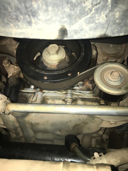

    The pictures in you original post are exactly like what my truck looked like when the timing chain cover started leaking. I never noticed any oil staining where I parked in my driveway. I check my fluids every time I gas up and found my dipstick dry, so I lost almost 3 quarts over a 10 day period. I freaked out a bit as well. I discovered this about 2 months post frame swap and took it back to the Stealer. The quoted me over a $2000 repair. I started doing some research and learned the 1GR-FE engines are prone to this problem. A result of poor machining on the mating surface of the timing cover; there was a TSB issued in 2008. Toyota may have remedied the problem by 2010, if it might be worth looking into. Good luck!

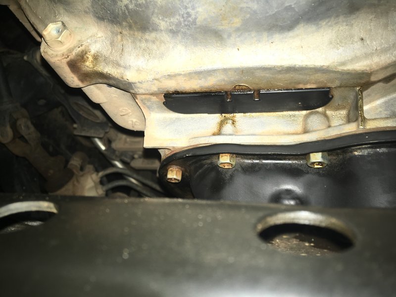

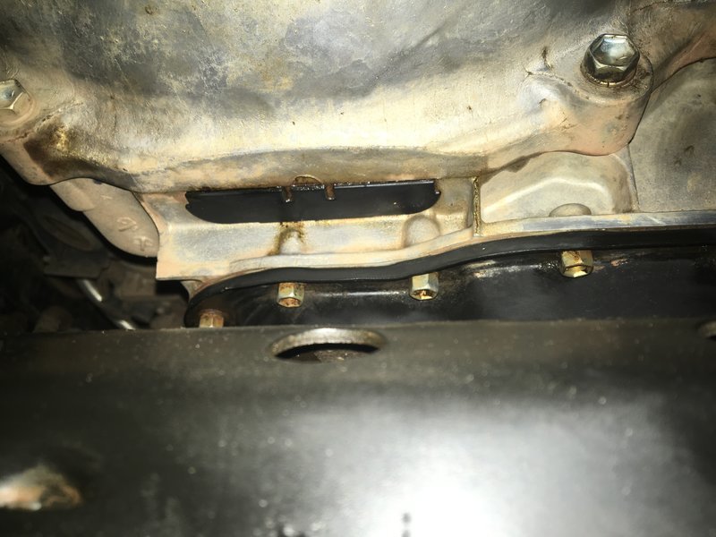

    Torspd Custom Turbo kit [] Borg Warner 9180EFR Turbo [] Haltech Elite 2500 [] TiAL Q BOV [] TiAL V44 Wastegate @ 15psi [] CP Pistons [] CP Carrillo Rods [] ARP Head studs [] ARP Main Studs [] ARP Header - Head Studs [] Ported Heads w/ 1mm oversized valves intake/exhaust [] Brian Crower Forged Stroker Crank [] Darton M.I.D. Sleeved Block [] Kelford Camshafts [] Torspd 160* T-stat mod [] APR Large Fuel Rail [] Walbro 460 LPH E85 Fuel Pump [] FueLab FPR [] APR T56 Conversion Kit [] KP RACING Built T56 [] McLeod Racing Custom Twin Disk Clutch [] One Piece Aluminum Driveshaft [] MGW Shifter [] Custom lowering kit [] Ohlins Front Coilovers [] QA1rear shocks [] Custom Ron Davis Radiator [] Dual SPAL Electric Fans []
    It is your front main seal. Plain as day to see in your pictures. It is higher than your oil pan. Thus it dripped down to the oil pan.
    The "bump the engine" method will be your easiest to remove the crank bolt. Unless you have a good impact gun.
    Flat head screw driver will be used to pry the old seal out.
    Put grease on the new seal, where it interacts with the crank pulley.
    Reinstall. Done.
