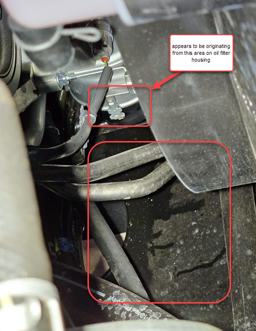

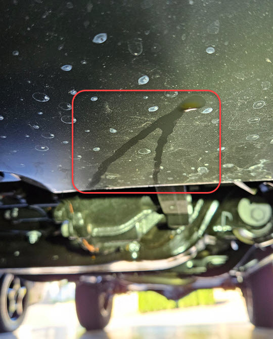

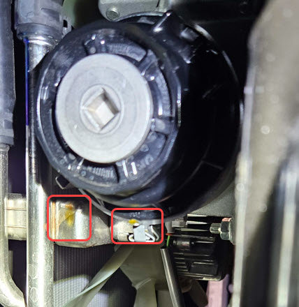

    Hi all. Since I had oil leak issues with the brand new Frontier I had a few years back, I crawled under my brand new Tacoma yesterday just to ensure everything was dry. To my surprise, I found what appears to be a pretty substantial oil leak that appears to be originating from the oil filter housing area. Truck has ~700 miles on it.
    I'll let the dealer deal with fixing it, but my question is - is this a common trouble area for these trucks? I've been browsing the forums the past couple weeks, haven't seen any other posts about leaks in this area. I've seen plenty of discussion about the timing chain cover leaks, but this doesn't appear to be that.
    Also, how in the world do I get a good reading on the oil dipstick? Every time I pull it out of the tube, the ridiculous bends end up smearing the oil along the dipstick.
    UPDATE: Dealer says it was an oil filter seal not properly seated. We'll see if it leaks going forward. This is my first experience with cartridge oil filters.
    UPDATE 2: Got it back from dealer and it's still leaking from the same spot. Guess I'll be making a trip back to the dealer. Best I can tell, all they did is remove the oil filter, reinstall it, then top off any oil lost.
    UPDATE 3: Tentative resolution in post 14

    That's unfortunate. Thankfully no, that leak is not a common problem at all. Probably a simple assembly issue in your case. The timing cover is definitely a far more common issue.

    If it’s coming from the oil filter cartridge check for cracks around housing it might have been over tightened and cracked the housing .

    Maybe it was just loose? I don't recall seeing a lot, if any threads about oil leaking from that area.
    I'd say just make sure the dealer handles it and documents it, get err fixed up, and be on your way. If the oil level looks fine, I wouldn't make a huge fuss about it..shit happens, unfortunately.

    Maybe the o-ring isn’t seated right from the factory

    I think it's just a loose filter. On reading the dipstick, I've found that letting the truck sit for at LEAST ONE HOUR (not the 10 minutes or whatever the manual says) takes care of the smearing issue and provides a good/solid read. Anything less than that seems frustrating!

    It took two trips to the dealer, but I think it's resolved. They say it was the oil cooler assembly, and it was replaced. It appears to be dry so far.
