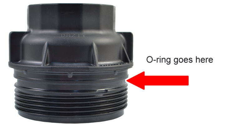

    Is the O-ring seated in the correct groove instead of on the rib above it? :notsure:

    Usually when the filter cap leaks like that the O-Ring is in the wrong groove....download.jpg

    The O-ring is in the groove that I removed the old one from. The groove directly below the threads as pictured.
    It's not a canister style filter like the 2nd gen. It's the dumbass reusable housing style that Toyota decided to use instead.
