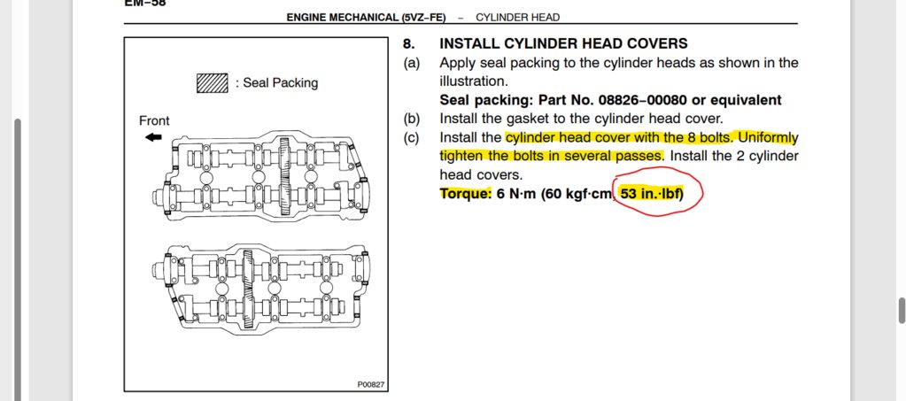

    The solution is to replace the worn gaskets and bolt gromets. Tightening the bolts is a bandaid.

    Just be careful tightening them. At 53 INCH LBS, really easy to fk up.

    Were your bolts actually loose?
    Gasket and grommets can shrink over time leaving the bolts a bit loose. And yes, only tighten to 53 in-lb. If the bolts are loose then this could be a good solution to your issue, but if the bolts weren't loose to begin with and you just continue tightening them past 53 in-lb that isn't a good idea.

    Thanks all. Yes, the bolts were noticeably loose and required tightening. Smell still much better.

    I don't have a torque wrench that goes that low. Prefer not to spend alot for something I won't use often. Any suggestions on what to get?

    Harbor freight quarter inch drive bottom shelf like $17 bucks or less depending upon sale or not. That's like the cheapest option besides Amazon. Good torque wrenchs cost more
    Edit: HF $18.99 Texas but they have upper tier wrenchs also but cost more.
