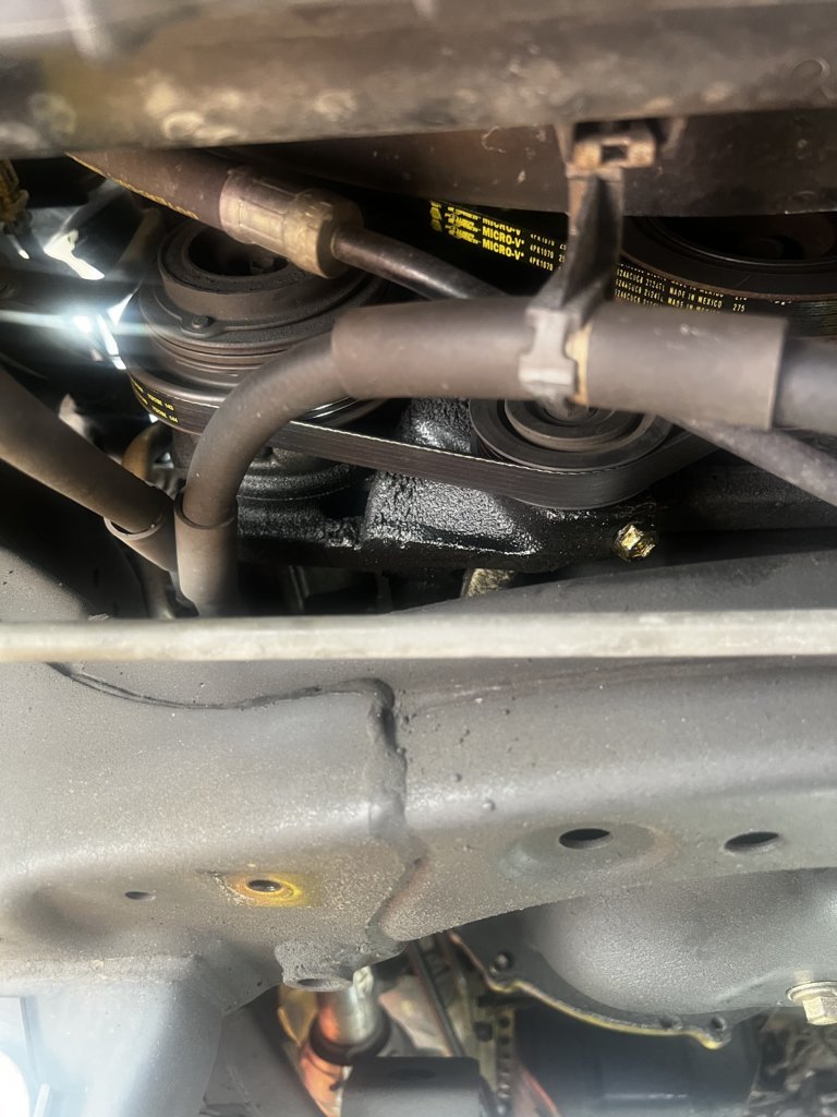

    IMG_9039.jpg IMG_9040.jpg Hey guys. I’ve been monitoring an oil leak on my 3.4 for a while now. Today while at work I took off my skid plates to see how it looked and I was wondering if I should start looking into replacing some seals, and if so, where should I start? Thanks!

    takes skill / experience to diag an oil leak & correctly...
    No cleaning required.....
    cleaning is actually what you dont want unless in fact you have no idea where to start, where the problematic sources are, etc...
    could be valve covers leaking down..
    could be your timing cover....
    could be just your front crank seal...
    Nobody is going to have a clue which from that picture.

    doing VC gaskets first would be a total waste of time & money if the timing covers leaking....
    Assuming they overlap, no idea what engine....

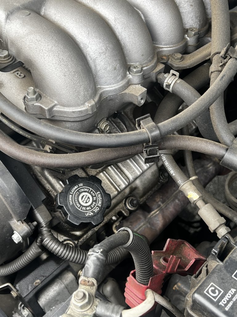

    VC gasket leaks are super common on these Tacomas (3.4L engine, pretty sure what OP has) whereas leaks from the cam and crank seals are close to nonexistent, at least to the extent on the leak shown. When I did my timing belt a few months back I debated doing the cam and crank seals and failed to find any instances on this forum where someone could show a meaningful leak from them.
    You can simply look at the edges of your valve covers and see if it is oily or clean. If they’re oily it’s time for a change (along with the cam shaft plug seals in the rear and half moons up front). You can also grab the upper rear of the valve covers and feel if those cam shaft plug seals are leaking. It’s more difficult to tell if the half moons up front are leaking.

    3.4L as stated in the original post. I’m not sure if they overlap, I’ve never done any replacements like this before

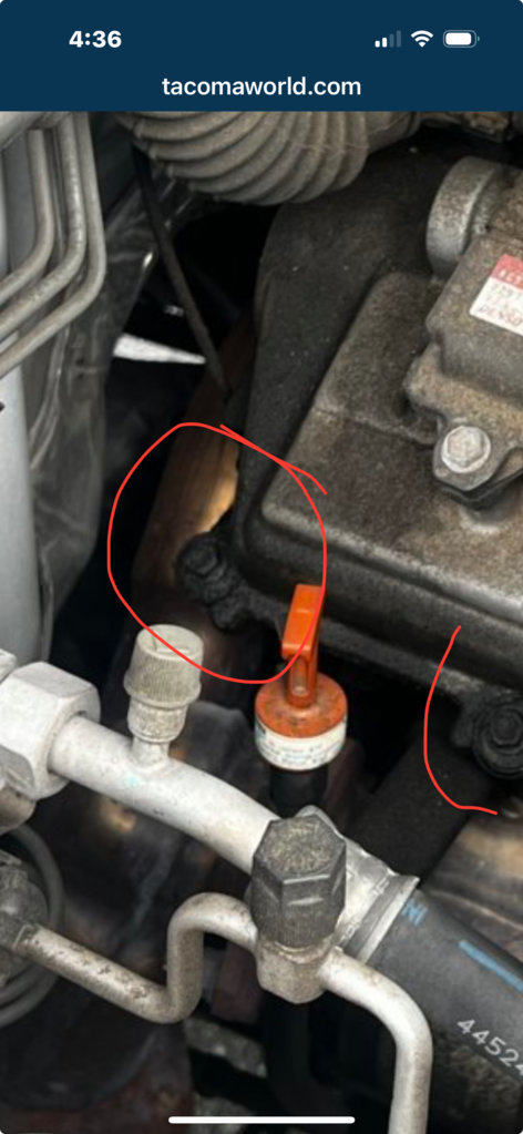

    They’re oily but I’m not sure if that’s from the bolts being loose or the gasket being bad. I might wash and monitor

    Well you clearly have leaking valve covers, very likely to be the source of the leaks you’ve been monitoring. At the point where you’re at tightening the bolts is very much a bandaid and you risk cracking the cover if you’re not monitoring your torque. If you don’t have the time and don’t care about losing a little oil and topping off it isn’t really a concern or a problem that must be resolved. But if you want to fix the problem then replace the gasket, cam shaft plug seals and redo the half moons. This video explains it all very well. It’s an easy job, just a little time consuming. Hardest part is wiggling the drivers side valve cover out.
