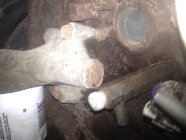

    So yesterday I walk out of school to find a small puddle of oil under my truck dripping from the skid plates. When I got home I layed down on my back and got under the truck to see if I could locate the source of the leak. After about 30 minutes of searching with a flashlight and wiping things off with a rag I think I have found the culprit. The oil is limited to the passenger side of the engine, and the leak seems to start about halfway up. It seems to be coming from the oil filter housing (the part the oil filter screws into that bolts directly to the block).
    I looked at the pan seal for quite some time to make sure that was not the issue. The leak is definitely above the pan seal. So now here are my questions for all of you. Is this a common leak area for the tacomas, and how labor intensive is the fix? It seems to be only three 12 mm bolts, but it's in kind of a tight spot. Has anyone done a write up on this yet?
    The leak
    The suspected leak
    Can anybody help confirm this analysis? Also, is there any diagrams or drawings with the parts and the part numbers floating around? If isn't a huge PITA to fix I think I am going to try and tackle this repair over the weekend. I will try and document and add pics here.
    Also, I just got the oil changed at jiffy lube and this started litterally the day after. Could this be a result of and improper oil change or is it just coincidence?

    That looks like residual oil from oil changes.
    Give it over the week end. I'll bet it stops dripping.

    My 3rz leaks in the same spot too. Not enough to mark it's territory but to leave a residue all down the side of the motor there.

    my 3rz was gushing oil from there, bad. i searched and searched and didn't come up with much luck.
    anyway, i went to the dealer and bought the seal and o-ring and replaced them. very easy fix.
    remove the three bolts and replace
    there is a o-ring type seal that seals the housing/perch off from the block and then one on a stem of some sort on the inside (i lack technical terminology) i had to cut the inner one off it was so flat i couldn't get it off any other way.
    it's easy. good luck

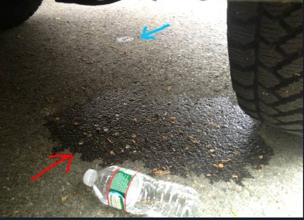

    I went outside on my lunch break to find a HUGE oil puddle near my passenger side front wheel(red arrow). This is significantly more oil than yesterday's puddle, it is also in a different spot. There is also another small puddle in the same location as the original drip spot(blue arrow). Something is leaking for sure. This parking spot was clean this morning.

    It's time to pull the oil filter housing. I'm sure there's a o ring or gasket in there.

    Yup, looks like it let go almost completely. Seconds away from disaster possibly. Oil light might be to late for that one,,you can pump quarts out very, very quickly and you only have a few. You would be surprised.
    Mine weeped just a bit when it was right off the lot. Took it back and they changed out those seals as I was told. No problems any time afterwards (crosses fingers).
