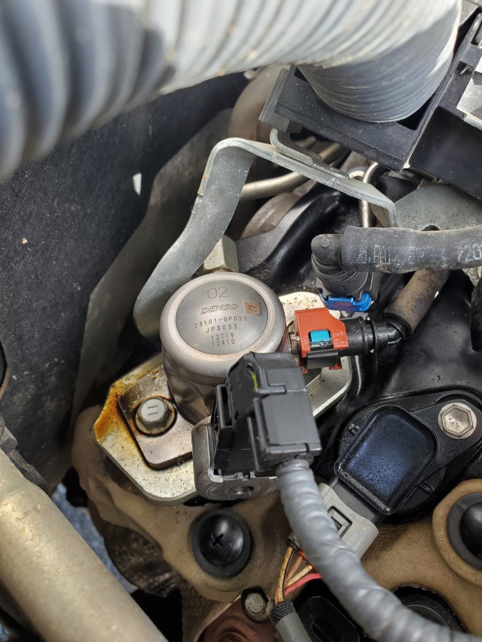

    I have been experiencing a small oil leak from the top of my passenger side head. it seems mainly centered around this sensor. Truck operates and drives fine, no codes, no suspicious noises.
    as this oil accumulated it drips down onto the exhaust manifold, which is how i discovered it, due to the smoking/burnt oil smell.
    Truck is a 2017 with 110k miles.

    That looks to be the high pressure fuel pump seal leaking.

    does engine oil run through there?
  5. Nov 10, 2022 at 8:29 AM
    Arries289
    Arries289 Yo!
    Apr 17, 2018
    #250874
    1,307
    Franklin TN
    2018 TRDOR DCSB BBP 6MT Tech & Prem
    The fuel pump has a plunger that contacts a lobe on the camshaft. There is a seal that keeps oil in the engine.

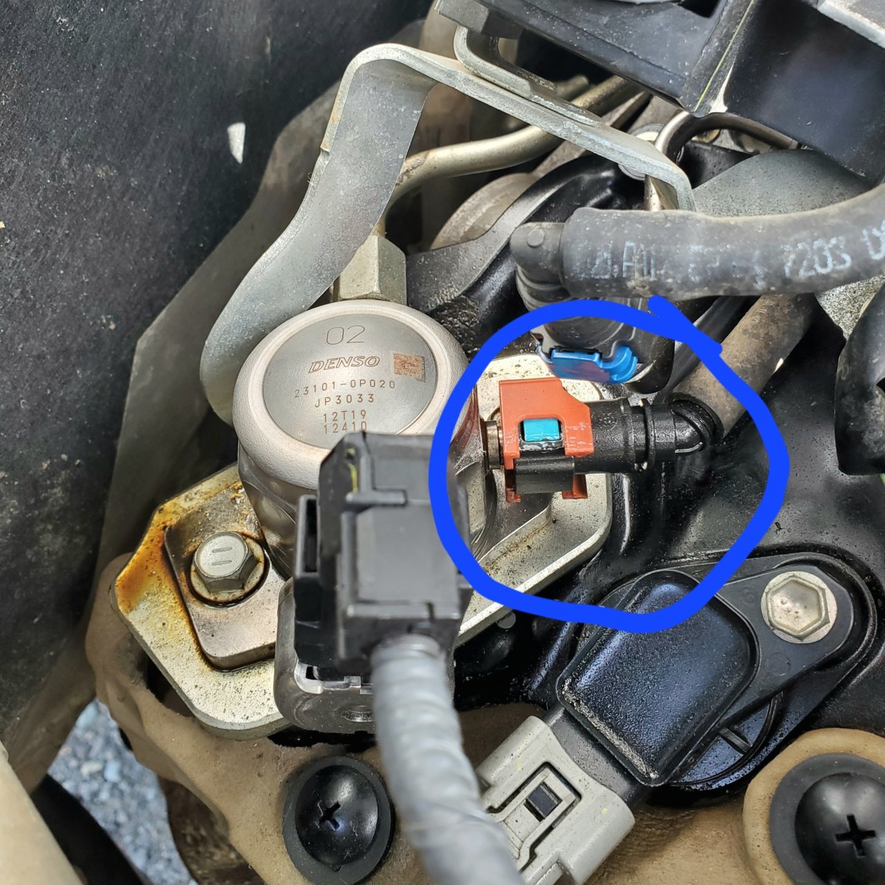

    what is this line right here? is it some kind of breather?
    or is that the fuel pick up, and high pressure output is in the back?
  9. Nov 10, 2022 at 8:41 AM
    Jowett
    Jowett Well-Known Member
    May 5, 2016
    #186182
    1,625
    Brian
    North Adams, MA
    That is fuel supply into the pump.

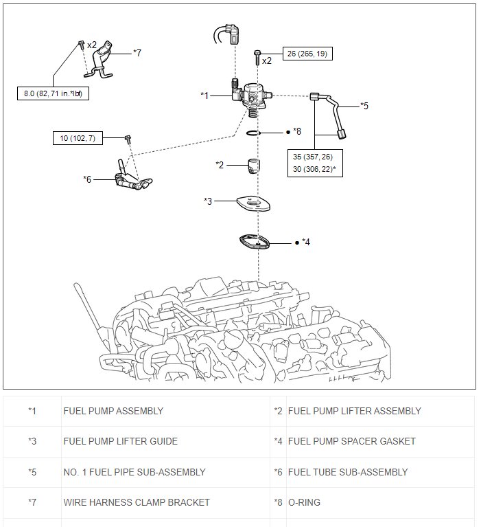

    Two gaskets there that can leak…
    90301-31016 #8 in below diagram
    23224-0P010 #4

    X2 on this... probably just a bad spacer seal underneath.
    That one in particular is a fuel tube.
