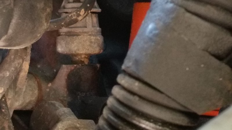

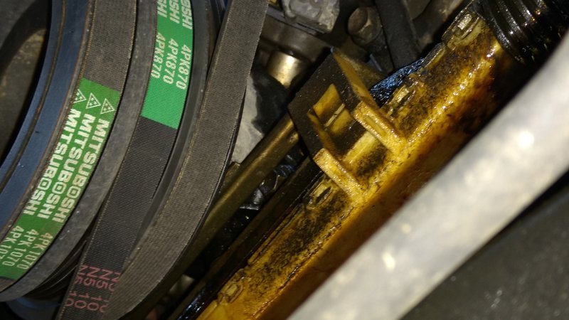

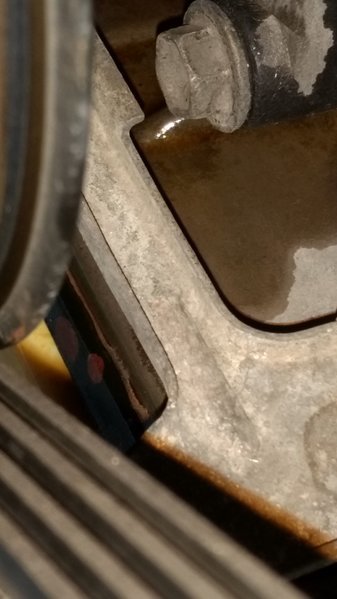

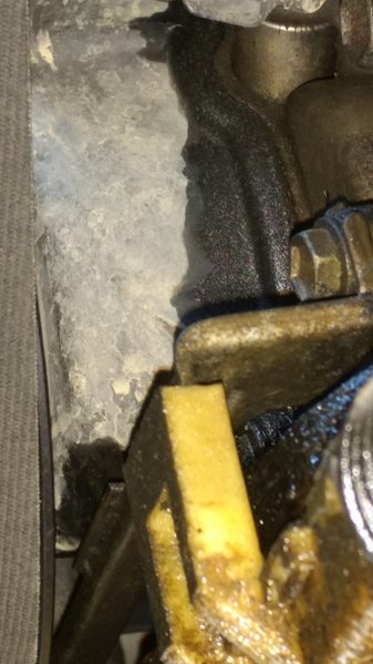

    Thanks Guys! Oil pressure switch is good. Could be that the main seal has slipped, but of course, I can't see that. It *DOES APPEAR*, looking from below, that there *MIGHT BE* seepage from BEHIND the aluminum, external portion of the oil pressure module that surrounds the main crank and seal. Again, Difficult to see. A few pics of the offending area...

    ooohhh yuck.

    Yeah, but those Mitsubishi belts look good, don't they???

    Good idea. I've pulled that tube a few times, and that o-ring was getting a little long in the tooth. For some reason, your post also reminds me that my pic does not show the oil pump cover itself, but the outer water pump/timing belt/oil pump cover. The oil pump is behind that, up against the block.

    Lol, same exact thought crossed my mind... Mitsuboshi makes very good quality belts.
