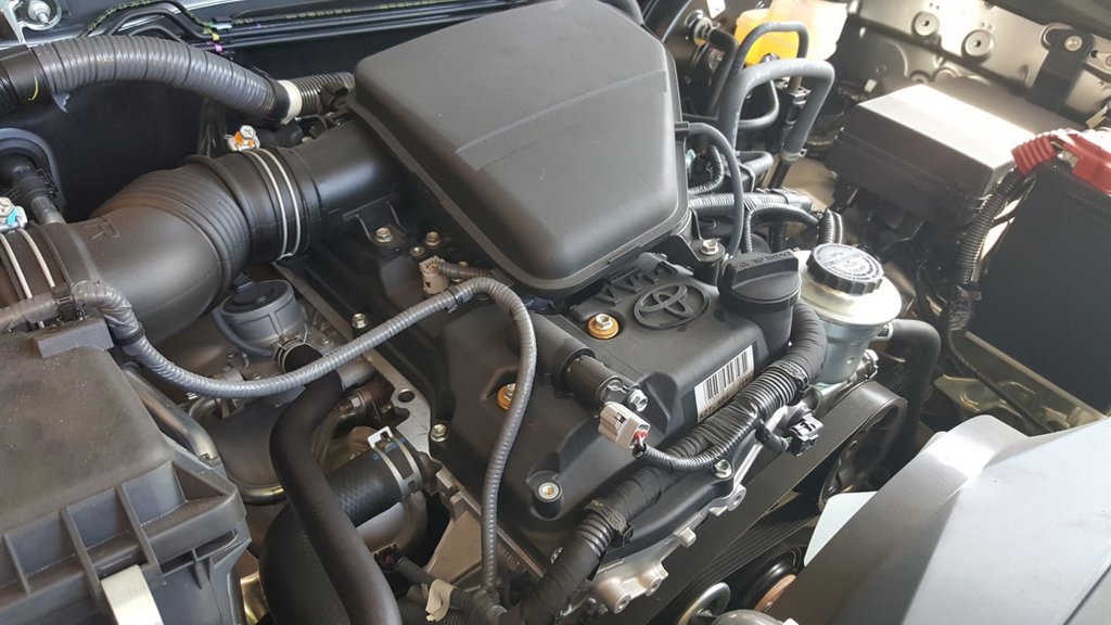

    So I recently bought a 2017 Tacoma with the 2.7. I noticed oil on top of the valve cover through other research I've found that it's the "camshaft timing actuator". I don't see a crack but that doesn't mean there isn't one there. Is there a common leak in this area? I've researched and I can't find much. Any help would be awesome. Also, while in drive with the foot on the brake the truck idles like it has a slight misfire. Idle is just above 500 rpm. No check engine light, no stored codes. Wondering if the two are related. Pic of the oil leak area attached, thanks

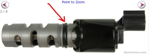

    There is an O-ring that no longer seals the valve. Get one and replace. Easy task.

    Vlady knows his stuff, and replacing that o-ring looks like a super simple job. One bolt, pull the actuator out, replace o-ring. It certainly shouldn't hurt anything. Looks like this:

    I cleaned it and took it for a ride and there was fresh oil in that ridge right where my finger is pointed to.

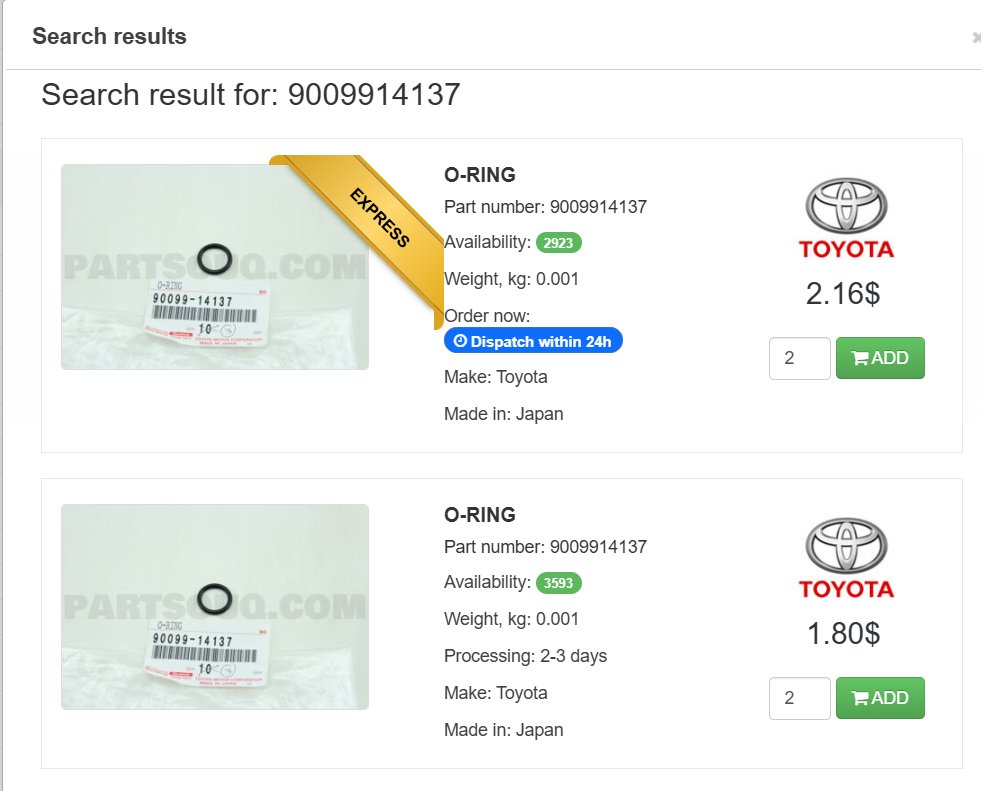

    Did some digging, this one isn't easy to find. You may want to search for this part number, or just order from partsouq.com.

    Have any local hydraulic hose builders that sell O rings? Take the old one and have them match it up. Done that many times over the years locally with O rings. Even many decent hardware stores carry them, just make sure you get one that is viton or OK to be used for oil.
    A decent shop will have a O ring measuring sizer that will measure both the inside and outside diameter.

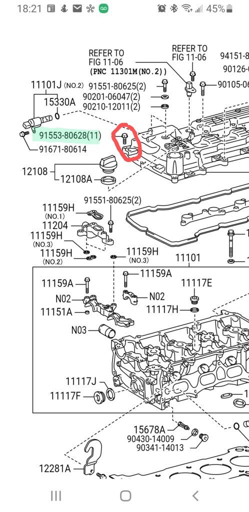

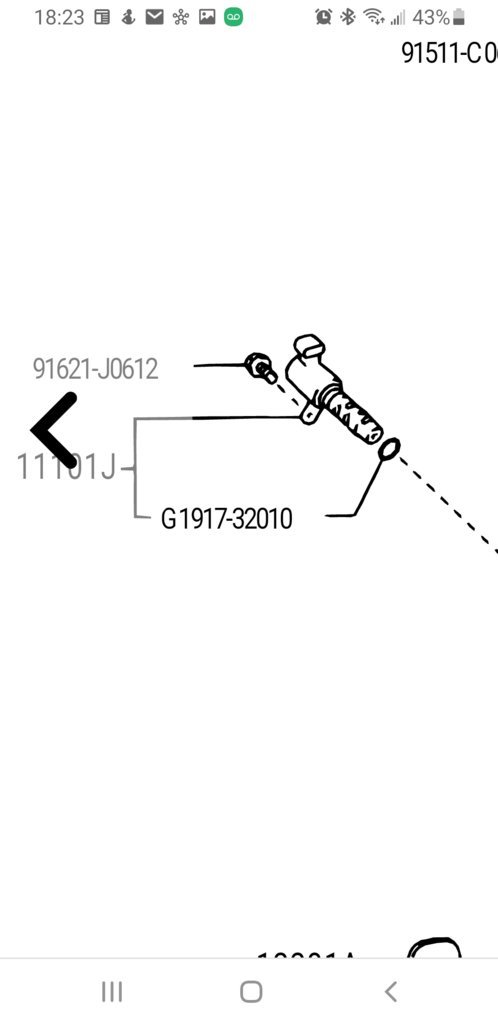

    I would go to dealer.
    Here is Parts.toyota.com diagram. The part is 11101J ( see disclaimer No.2).Toyota wants you to replace the whole thing.
    But you can get this part
    G1917-32010

    The oring is cheap, the oil control valve is expensive-er

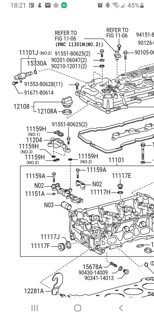

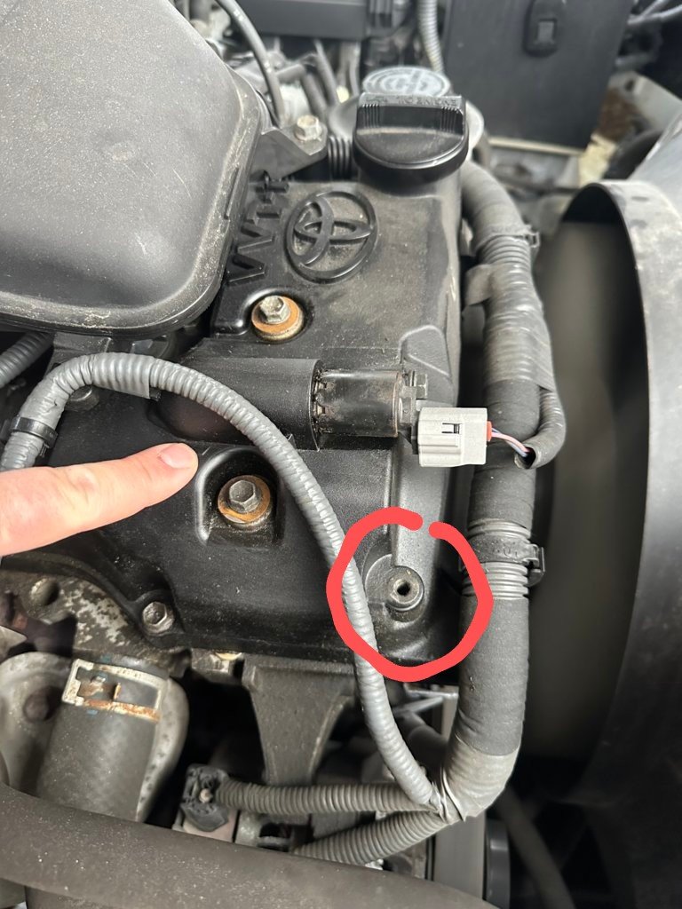

    It looks as though a valve cover bolt is missing from the corner of the cover. Part# 91553-80628 in Vlady's drawing.
    TheWildMan and fathomblue like this.

    Good eye! I know I would never have spotted that.
    The bolt in question:
    Sure looks like there's a bolt missing.

    The "missing" bolt is concealed by the wiring harness...
    (not my truck)
