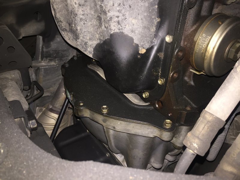

    That's the oil pan to the left and the transmission to the right, something is leaking. Not low on oil... maybe oil pan? Or rear main gasket? Thanks for your help in advance

    Some more pictures also background on how you noticed/when you noticed. How the truck runs/feels would be great

    start your leak finding forward and up of the leak. gravity brings it down and vehicle movement pushes it back. clean it all off and then take a few laps around the block. find the leak

    Check the back of the valve covers.

    It's not a rear main or else it wouldn't be on the side of the block. Its coming from somewhere high. My guess would be either the valve covers or the oil filter housing where it mates to the block.

    Update: it's a small leak from the value cover and the crankshaft front seal.
