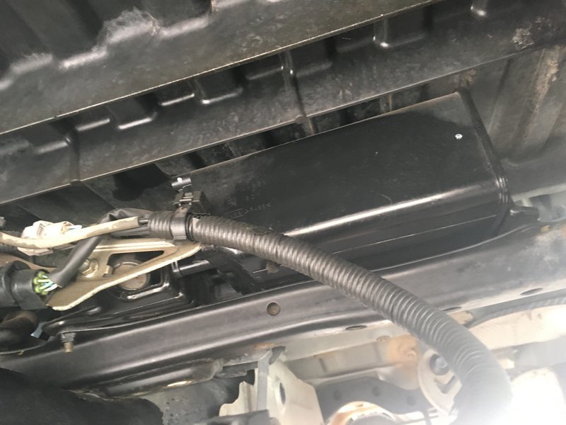

    hey guys i noticed oil allover the rear of my gas tank and i think it coning from this but i dont know any knkw what it is. Thanksimage.jpg

    That's your charcoal canister. No oil. It captures evaporated fuel.

    So of its leaking anything it would be fuel? Because there was a bunch i if on the rear side of the gas tank

    Sometimes grease from the prop shaft spins onto the gas tank, but there's no concern over that gloss on the charcoal canister.

    Clean it off real good and just watch it. I don't know what kind of oil residue would be on there as fuel is not oily. It's also a sealed canister so any leakage would be from the fitting connections.

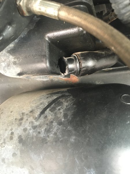

    Thanks for the info i just noticed this do you think it could be the culprit image.jpg

    Looks like you overfilled the gas tank and liquid fuel got in the canister. Do you fill it past the "click" of the pump? And yes that hose is an issue. Check engine light on?

    Doing this in hot weather can make it worse too.

    Ya i just recently filled it and i just went one time past the click and no the check engine light is not on. And ya im shure thats the fitting that broke

    I'd just replace with a good used oem part. Though if you like new, it's not as bad as I though. I priced one out for a Nissan and it was like $400-500.
