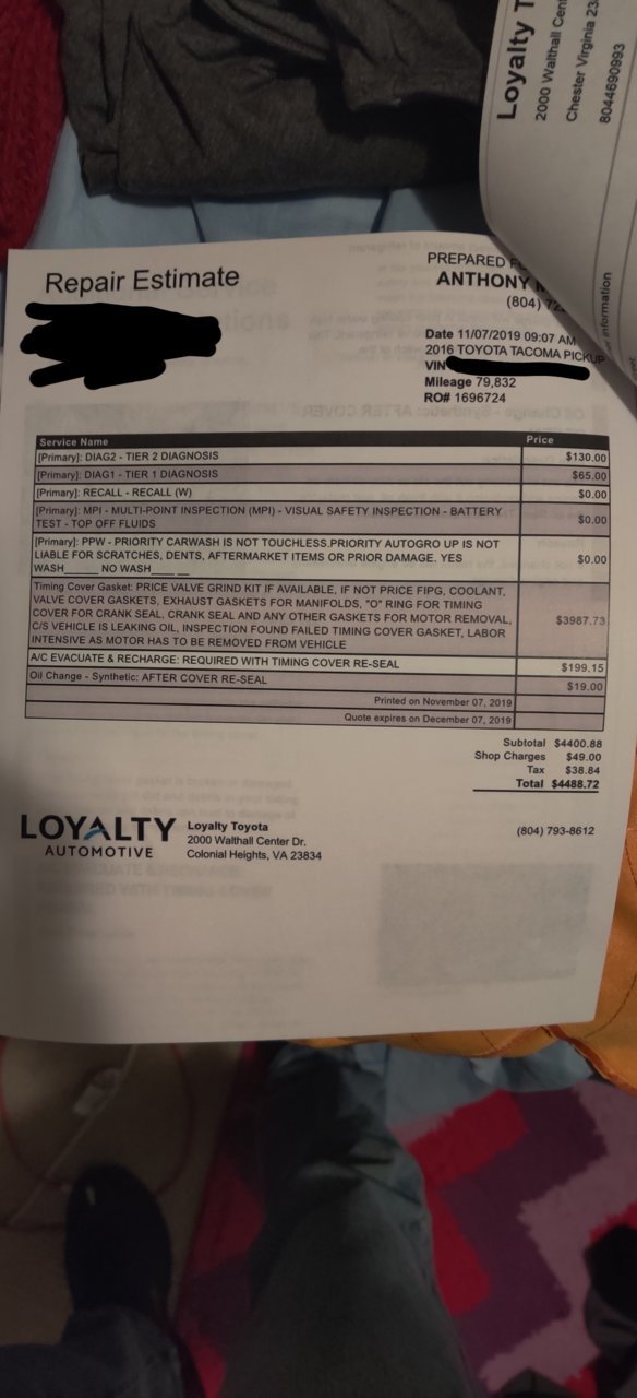

    i just had my timing cover gasket replaced. they did infact pull the block on mine. originally they said they didn’t have to. replaced a ton of seals and gaskets, pulled the AC and recharged that with that 1234yf stuff that apparently is nasty.
    they were going to look at my needle bearing- found the tsb on it. (they tried at first to blame it on it being lifted) advisor said it was bs since the tsb applies to a stock truck, so they can’t blame it on it being lifted causing it. so they are ordering a diff now. free stuff is nice, just always fear what gets screwed up in the process of it.

    I had a similar issue, and got a bit of a run around from Toyota. I had noticed I kept getting a low oil light and dutifully took it to two separate dealerships to have them look at it and both times, they replaced the sealant gasket in the lower oil pan but with the warning to monitor the issue. I went back to the second dealership a second time and they found a crack in the upper oil pan and it was the cause of my problems. By the time it was found, the truck had just passed over the 60k drivetrain warranty threshold, so I had to turn to my insurance to get it fixed. It took about 2 1/2 weeks to fix, but they didn't have to pull the engine out.
