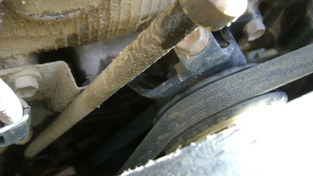

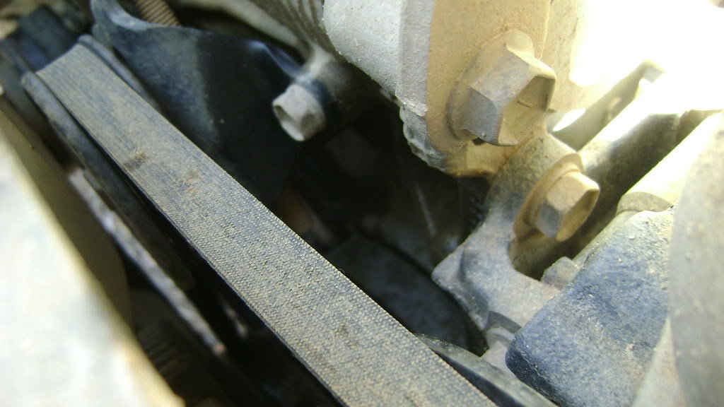

    At the rate it is leaking if it were any faster it would be a steady stream. I had the truck running for 5 mins at the gas station and it had a 8" puddle on the ground.
    It seems to be coming from over the crank and below the valve cover. It is running down the front of the engine and dripping off the crank case. Could it be the top of the oil pump leaking?
    With lighting it was difficult to get a pic but behind the tensioner pulley and a little lower down is where the oil is coming from.

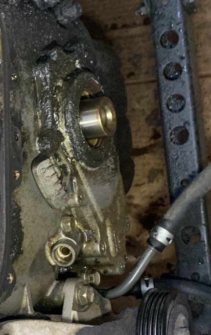

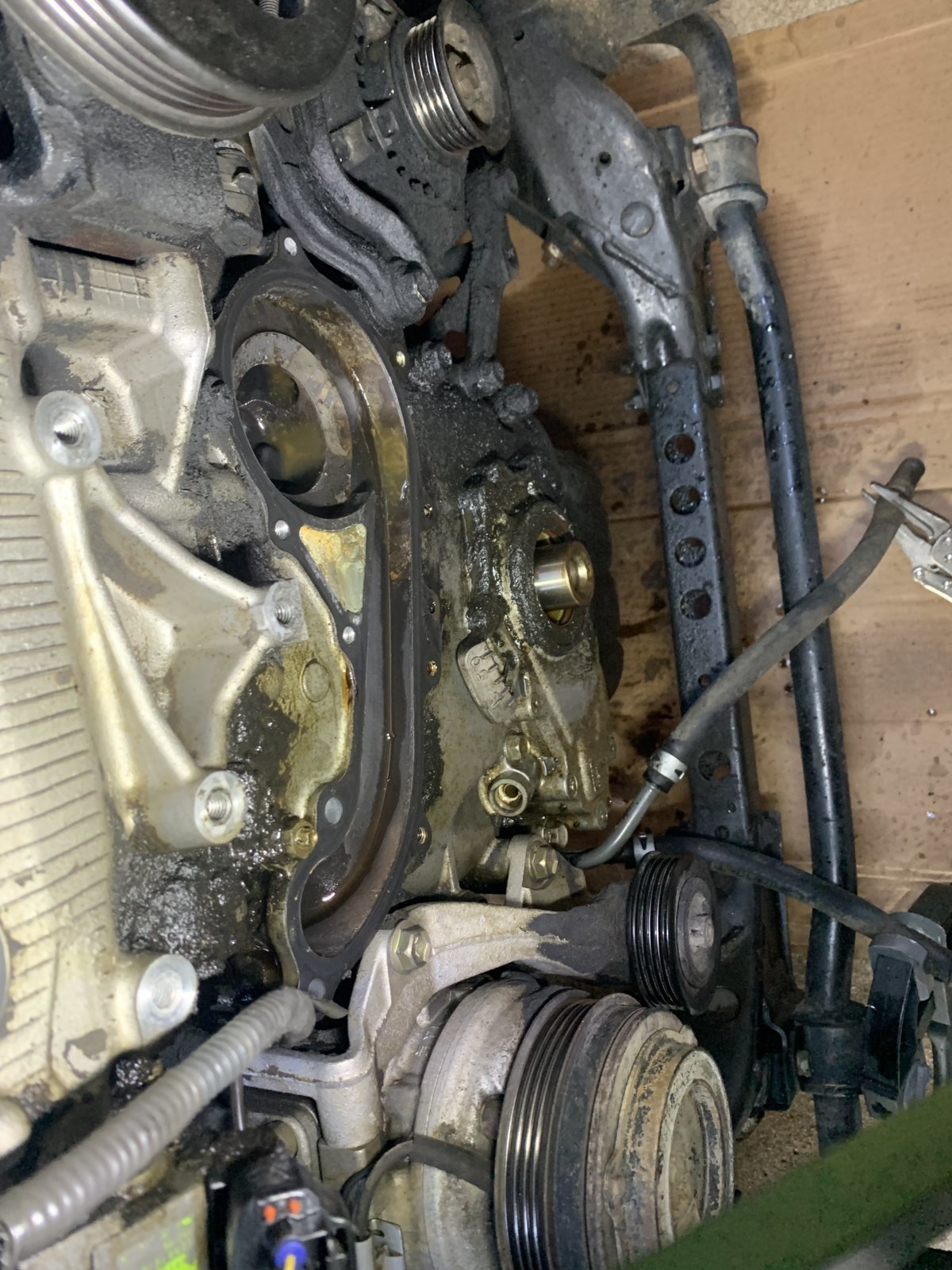

    You're gonna have to tell us where It's originating from....
    above or below the water pump .....and then on the left side or right side (looking from the front) of the timing cover....
    maybe take some pics......or better yet clean it ....drive it for a while....and then take pics....
    for example this looks to be leaking from the top left side(looking from the front) of the timing cover....right at that triple joint....where that 1" bead of RTV should of been....when they put the head back on....on top of the timing cover and block.....
    BUT......Most common place is the oil pump cover.....down there lower.....

    Yep.....your right......I stand corrected....because of those rubber washer screws.....valve cover gasket is the no1 most likely to leak....
    However....in my defense....that is the easist to detect and diagnose...
    And fix...thank God....
    If you have your truck long enought....you'll most like get that visit.....
    and a lot of times its that rtv/fipg bead that fails......right at another triple point...
    in this case....the moons...
    Reason its so important to pull and redo those half moons at that same time......or your making a big mistake...
    And if they'rre the rubber ones.....crack that wallet and buy new ones....
    ask me how I know......ugh......
