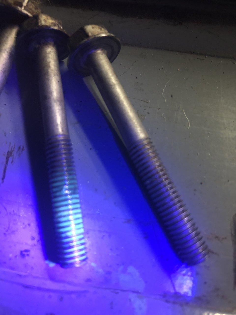

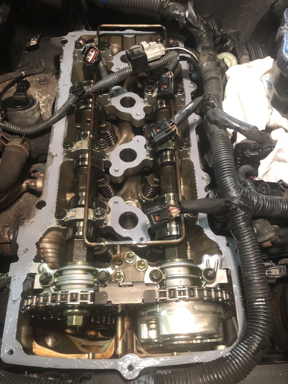

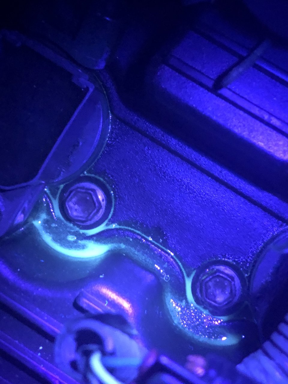

    Sooooo....I pulled the valve cover again...after using silicone the rear of the seal no longer leaks, but I have found that I didn't put enough silicone down for the center gasket because I see oil leaking from the bolt holes. So, if you are doing this job on yours, use plenty of silicone the first time on everything. I will try to redo it again when I have time. Hopefully I can save the new gasket.

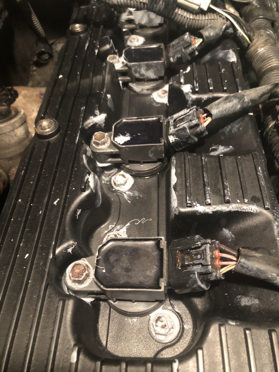

    That third pic was my attempt to just goop the daylights out of the leaky bolt areas, but alas, I will need to pull it all over again....

    Maybe I had a stinky new gasket to begin with....should've gone with name brand...

    Update: redid with new gasket. I made sure I used the right amount of RTV Sealant, ¼” bead, especially in the center gasket spark plug port area. Worked great. Learn from me and do it right the first time.
