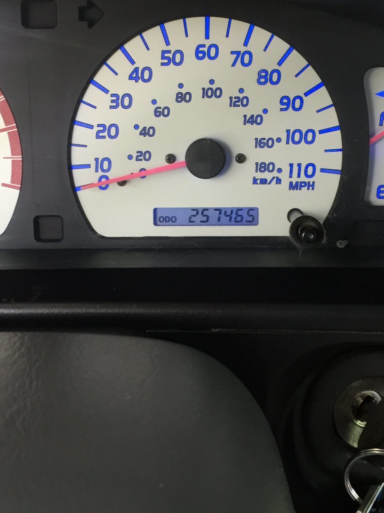

    I use Royal Purple HMX for high mileage vehicles on my 04 3.4 V6 Tacoma with an OEM filter and I've never have to add oil. No leaks whatsoever either. Here's my mileage and I've been using for the last 157,000 miles.
