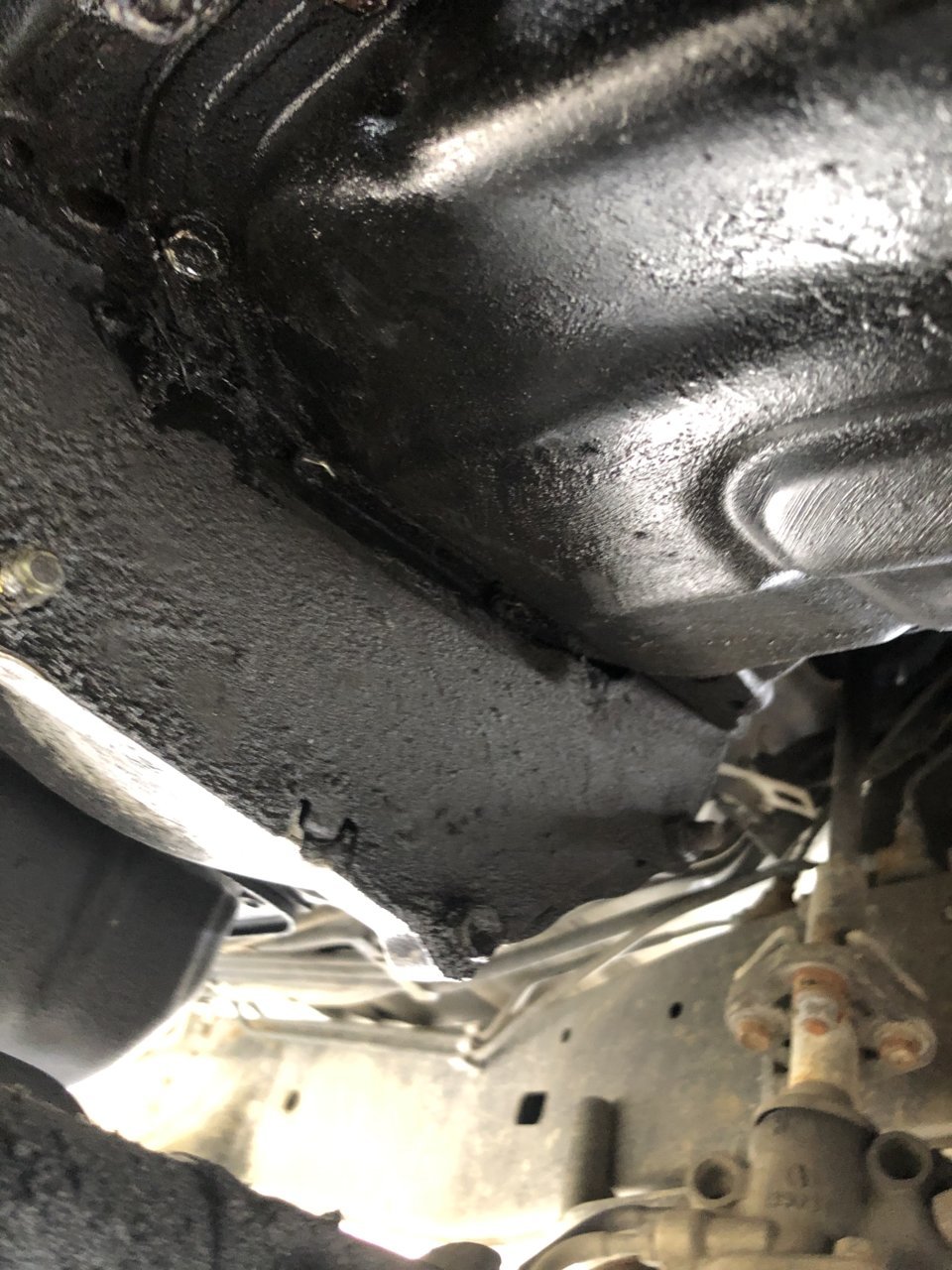

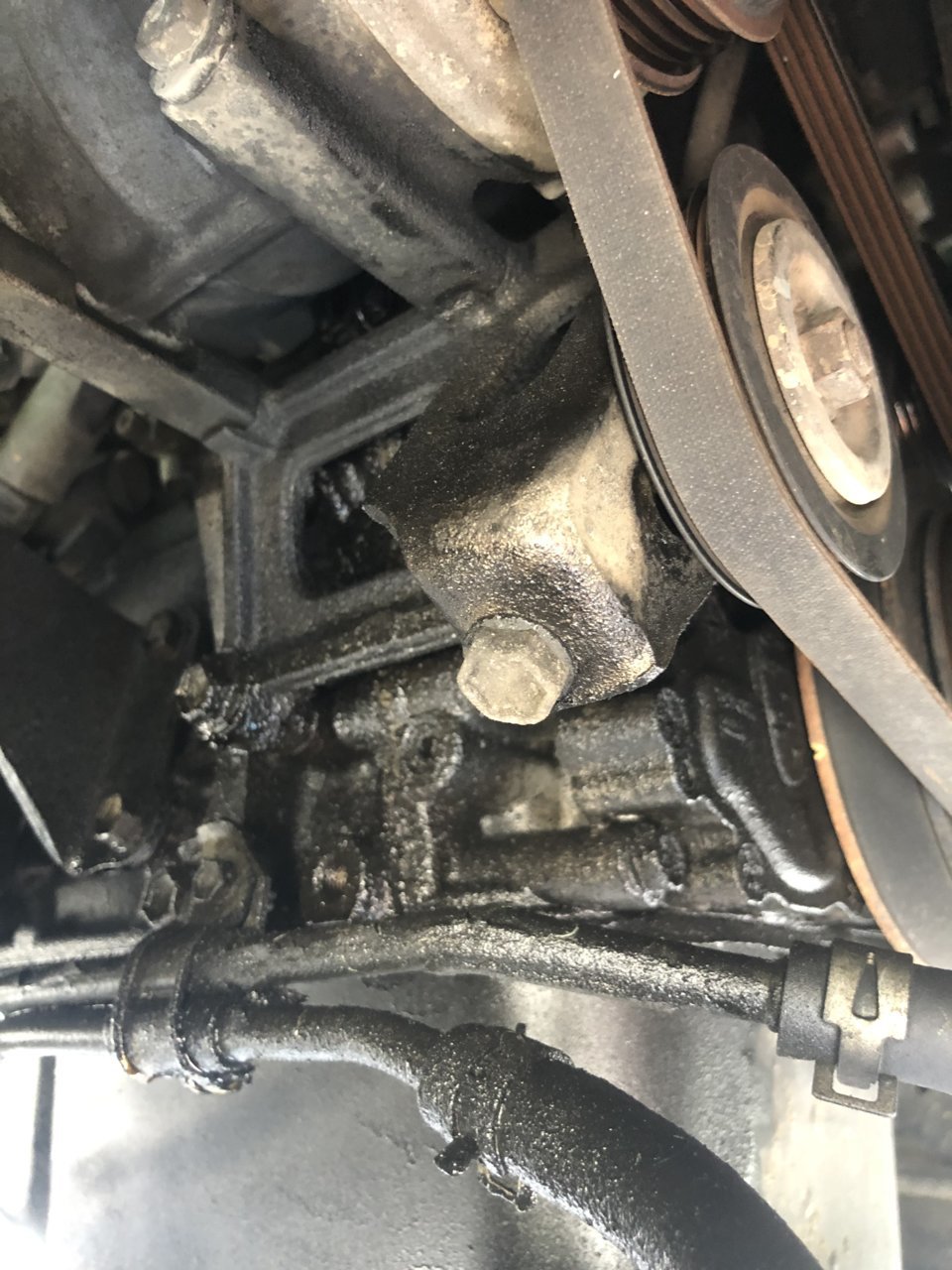

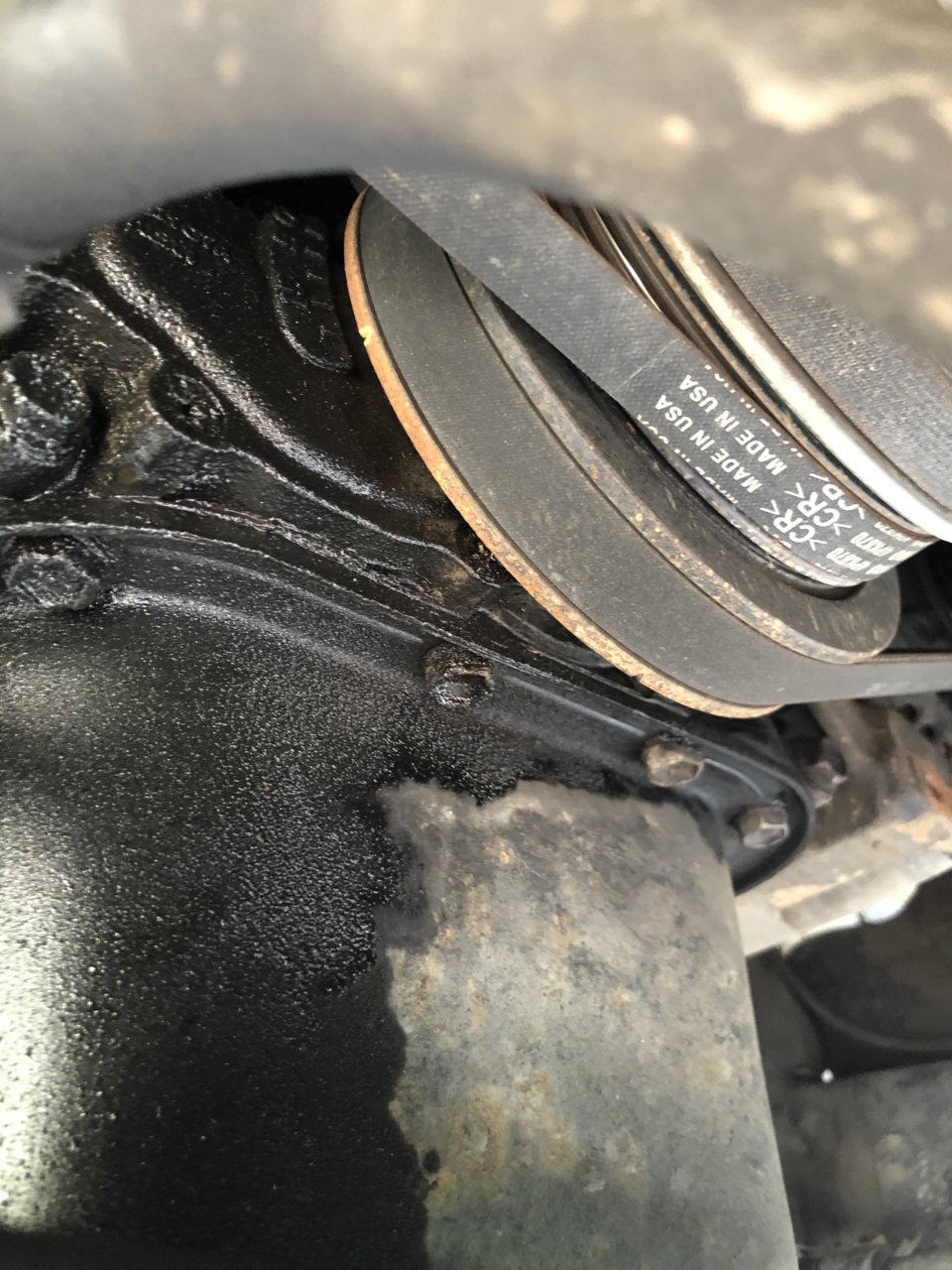

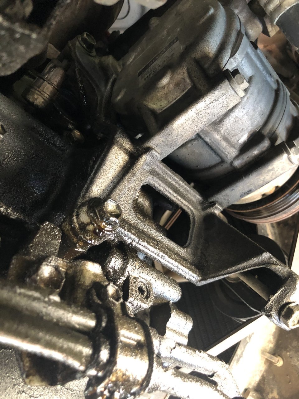

    Okay I got some pics. All the oil is on the right side of the engine and it looks like it’s splashing backwards on stuff. It weird because I saw this stuff caked where the back of the oil pan os in one of the pictures as well and I took it off with my fingers and it flaked off. Is it a gasket?
    hopefully the pics are good enough. It’s hard to snap them under the truck.

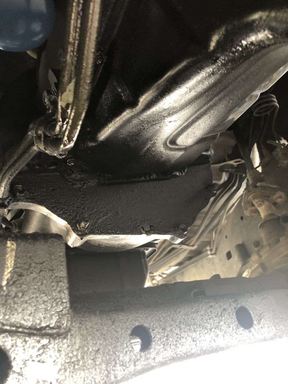

  14. Feb 21, 2020 at 12:05 PM
    Tacotruck7
    Tacotruck7 [OP] Well-Known Member
    Sep 8, 2016
    #196797
    2,189
    SoCal
    04 Prerunner Dbl Cab 2.7L
    Here’s a few more pics as well.

    Is there any oil from up top it would be a freeze plug or block off plate in the left front of the head itself. some heads have a hole there for other vehicles that use that head. I had one that leaked there too.

    You'll see the coil pack bracket and a thin piece of metal there behind it. Usually a freeze plug but this one wouldn't seal up so out came the plug and I used right stuff and a piece of metal to cap it.
