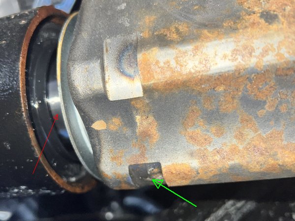

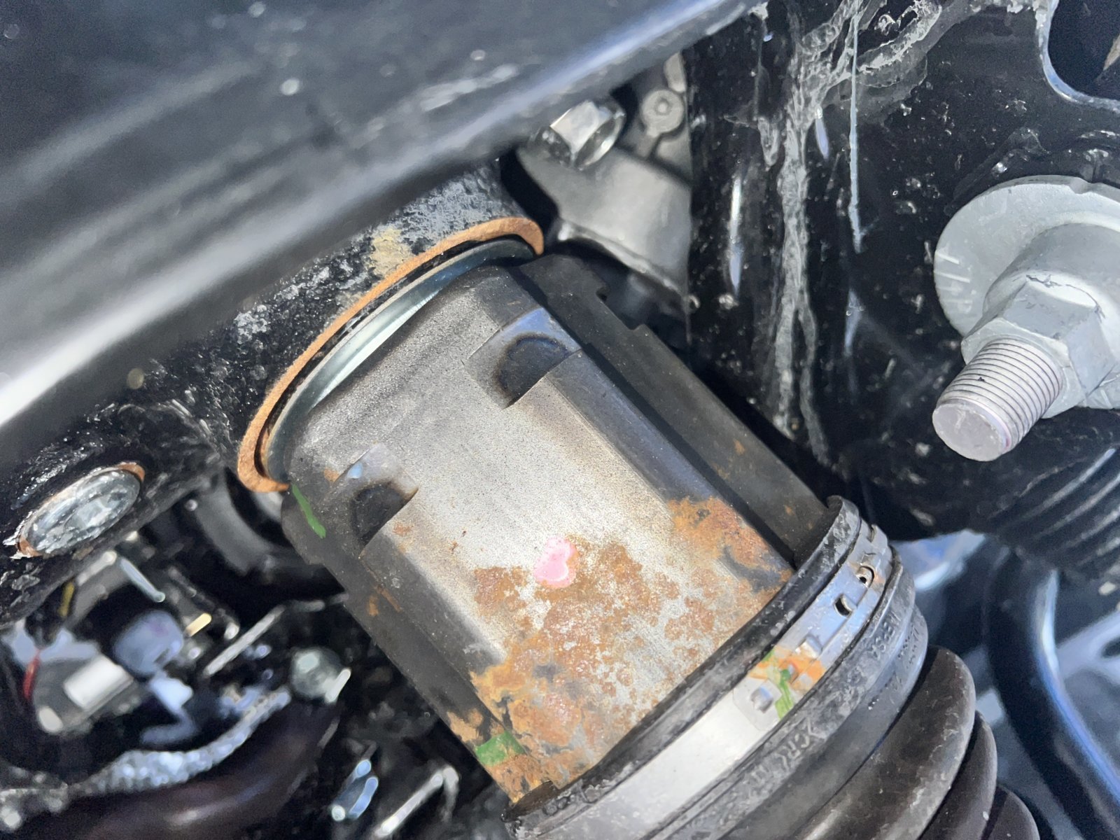

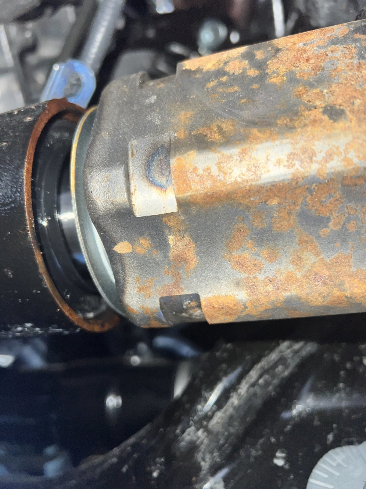

    So I just got under the truck to try and trace it and the first thing I noticed was a large gap in the passenger cv shaft and realized it was not motor oil but rather gear oil (should have known better by the smell) so with this new information should I be as concerned about wrecking the diff over the next week? I’ll attach some pics of both sides and you guys will be able to tell which is leaking but the drivers side looks a little out of whack too. Thank you everyone for welcoming me and quickly helping with this. You guys rock!

    That's no bueno. The red arrow I drew points to the sealing surface. If you can see that surface, the seal isn't sealing:
    Looks like the passenger CV joint popped out for some reason. This should be fixed before driving further. If you have a hammer and large pry bar or chisel, you can engage it in one of the notches (green arrow) on the CV cup and hammer it back into the diff. If you aren't able or willing to fix it yourself, call the nearest dealer for a tow (doesn't have to be the selling dealer).
    If you choose to fix it yourself, you'll want to top up the diff oil afterwards. That requires a 10mm Allen bit, new crush washer, etc.
