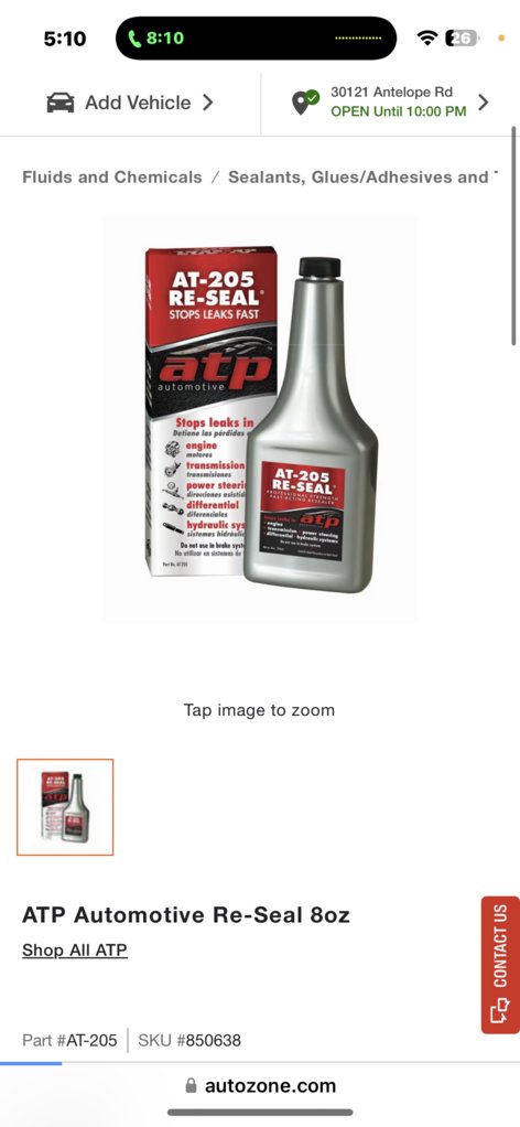

    Are Rear Main Seal, Front Crank Seal, or Valve Cover/half moon??? within the scope of DIY?
    AT-205 is suggested by Scotty Kilmer, any thoughts?

    AT-205 is the miracle cure it is advertised to be, but it is very temporary and doesn't work to swell or soften anything sealed with RTV silicone. Only natural rubber polymers. So rear main and front main may for a time slow their leaks but without regular use of AT-205 they'll leak again and eventually they'll wear out entirely since plasticizers like AT-205 can only do so much before the base material just can't cope.

    Stay away from cures in a can.
    You’d be better off not using them, than using them.
    Sure, under some circumstances they can “work”. But the those circumstances are very few. And they don’t fix anything.
    They mask the problem. And temporarily at that.

    Well, I think it was the rear main seal based on cleaning the dirt and examining. Was not totally sure. I poured the AT-205 into the oil fill, and drove for an hour and the leak stopped. Drove for a week and still no leak. So far, so good.
    This I do know... It leaked oil and now it doesn't. Oil change coming up FWIW.

    Looking for a temp solution , was this actually helpful? I have a turd gen and I’m planning to actually repair it when I get the money, but just needed to know if this will work in the meantime…

    This has worked for me on three vehicles.
    First was a 160k miles 1999 Town and Country van (don't recall the leak location) and the leak stopped for at least 60k miles when the vehicle was sold. Second was for a relative's car. It worked. Third is my current Tacoma. The Tacoma's leak was not the valve covers or the oil filter. Was not the front seal on the engine. Best I could tell with laying on my back on a piece of cardboard on a rain/wind day was PROBABLY the rear main seal.
    Turns out I had ordered it back in 2016 on Amazon twice. I forgot about those until I ordered again recently and Amazon identified it as a repeat purchase. My original purchase was the result of watching a Scotty Kilmer video.

    Sounds like a short term fix for a last ditch effort to an inevitable repair. Which is all good everybody needs something to believe in. Glad it's worked for you.

    Man, thanks for the thorough explanation and story. Most info seems to point to 50/50 in either direction; both to use for a temp fix and then not to use it because it will “not” fix it and that we should just bite the bullet and drop the transmission. I’m strongly leaning toward using it for to buy a few weeks/months until can afford to drop the 1350 + on the repair.
