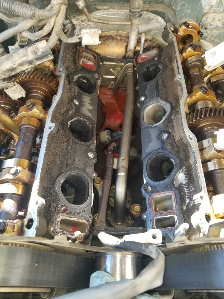

    So the valve covers and plenum are off, and left overnight. Came back the next morning to cylinder #6 full of coolant. Not sure what happened, but perhaps when i was taking the bottom half of the plenum off, something got knocked/squished when I was budging it with that one long bolt I forgot to pull.
    This leak could be the intake manifold or head gasket. guessing it's the intake manifold at this time. I spose a leakdown test in in order.

    Renting a compression tester in the next day, and will report back. Cylinder 4 has an intake valve out of specification. Going to recheck the valve clearances one more time before ordering shims, but the rest of all the valves appeared to be within tolerance.
    Removed the intake manifold, and it looks like cylinder 4 is steam cleaned. I've lost a minimal amount of coolant, not enough to drain the overflow tank over a couple months most likely.
    Yes, I remember it blowing minimal amounts on cold mornings, nothing too far out of the usual.
    You're likely correct in this assumption. Fingers crossed it's the intake manifold and not head gaskets. So far it's looking like it's an intake manifold gasket issue as cylinder 4 being the culprit right?

    im seeing the top curved portion of #4's gasket is very diff than others
    fingers X's tht only the I. gasket!
    when you look down into the steam cleaned #4 intake.......visual inspection shows any cracks on valve or valve seat??

    Visual inspection is a-ok, both the valves on number 4 are out of spec, and performed well with the leak down test. #6 intake valves were leaking air and valves or valve seats with blow by; those valves were within spec, so that's a bit odd. Guess I'll be taking the heads off and performing valve work along with head gaskets. considering ordering reman heads, or possibly doing all that myself.
