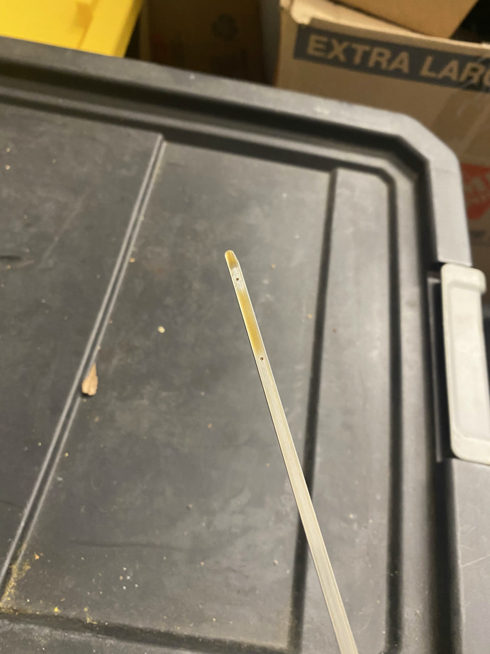

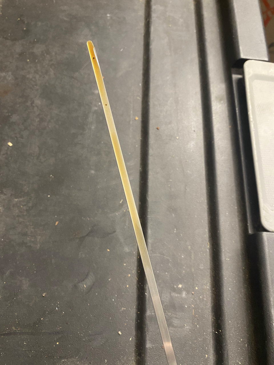

    Ok I am no where near new to cars and I am simply stumped at the moment.
    The proper oil check procedure per the manual is to bring the engine to operating temp. Shut off for 5 min and check the level. For whatever reason my level reads correct on one side and about 2" above full on the other, I tried it 10+ times every time same weird result.
    I feel like a total idiot not understanding how or why... Call me a dipstick but perhaps I am too trusting of the dealer and think they didn't make a mistake.
    Also I let the car sit overnight... and this is what the dipstick looks like (both sides). Does it read high after sitting overnight for you as well? I am only asking because technically this is NOT the proper procedure but I want to be sure before I tear into the dealership.

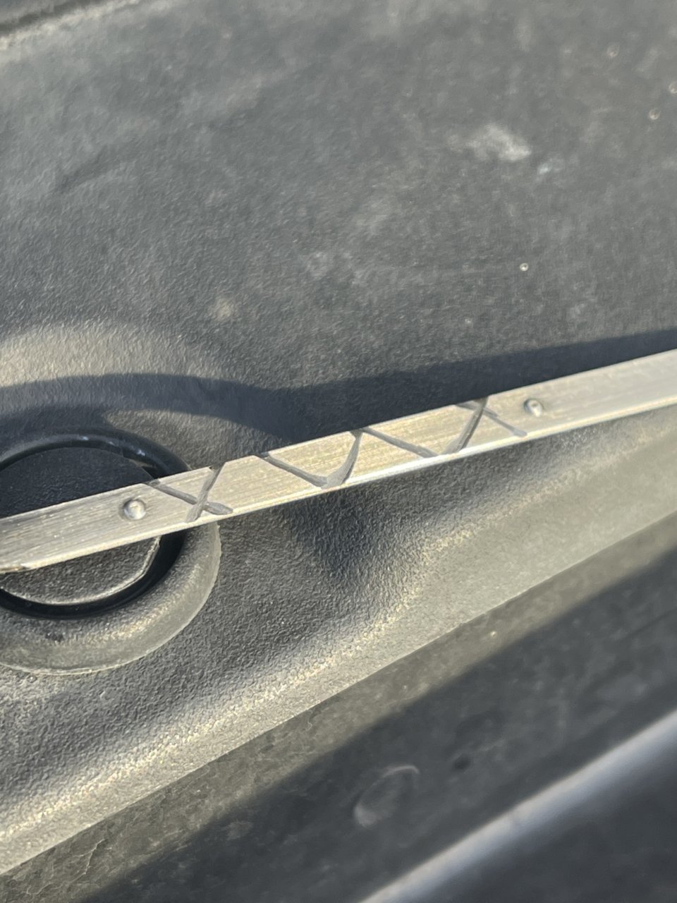

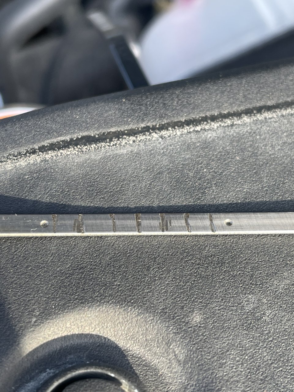

    It appears that all Tacoma dipsticks read funny. I'd go for the side that isn't streaked. Some lightly sand down the dipstick in the full area.

    +2. Thanks you two. This was driving me insane. I literally pulled it out and wiped it a solid 15-20 times and couldn't get anything worth a damn.
    However it seems like the proper way to measure the oil level is...
    Pull out stick... wait 3+ min quickly pull it in and out.
    I tried to do it one more time right after and once again, illegible garbage. The below pic is the with the only workable method. What madness.

    Yep... remove, wipe off leave it out for 5-10 minutes. Reinsert and pull out. I always check it with the engine cold. I found it helps to scuff/etch the dip stick diagonally in a cross pattern between the 2 marks with some sandpaper or file... makes it easier to read.

    Here's what I did. Also, don't forget to throw a lil dab of oil on the o-ring every once n a while so she doesn't lock up.
