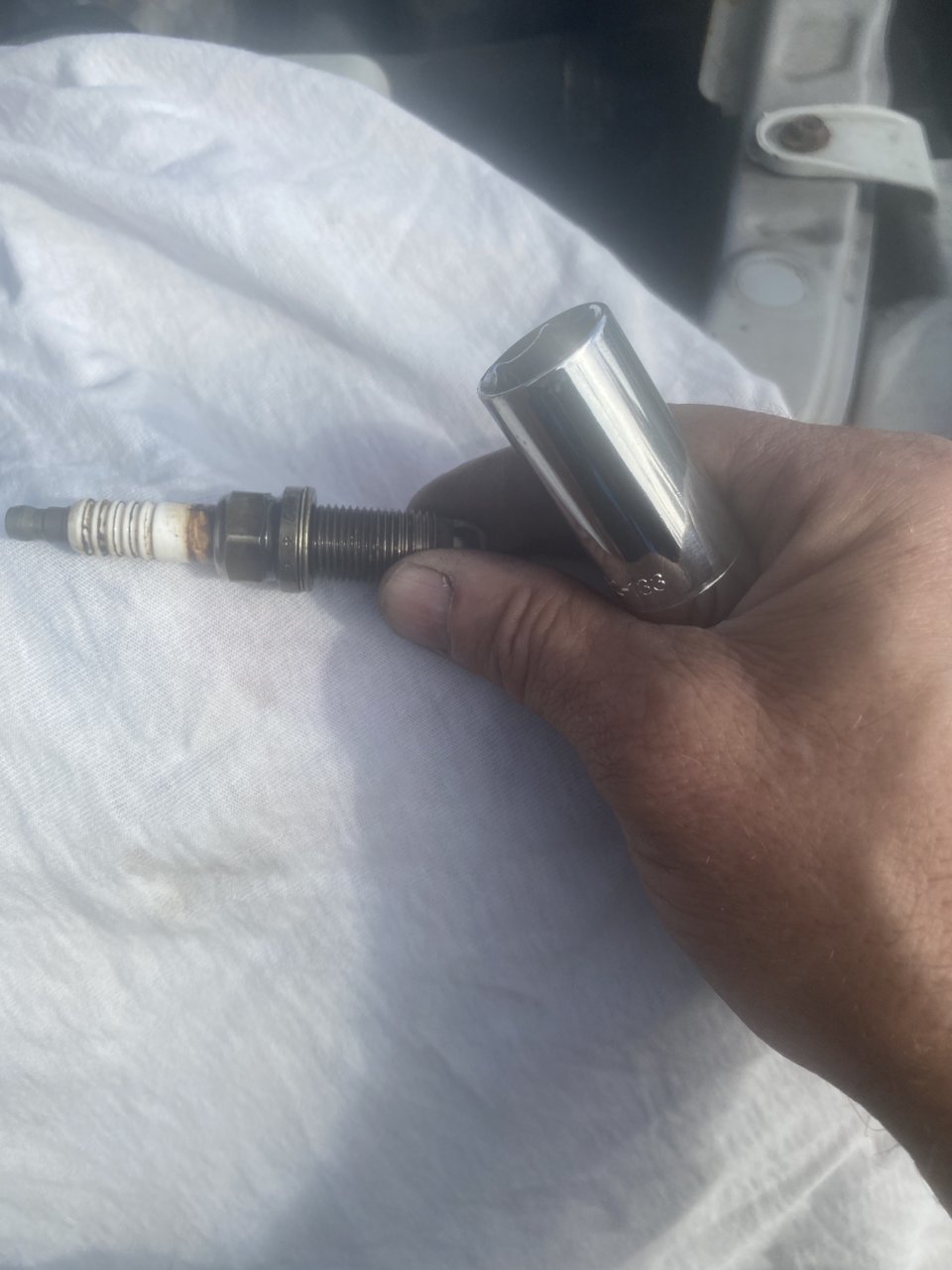

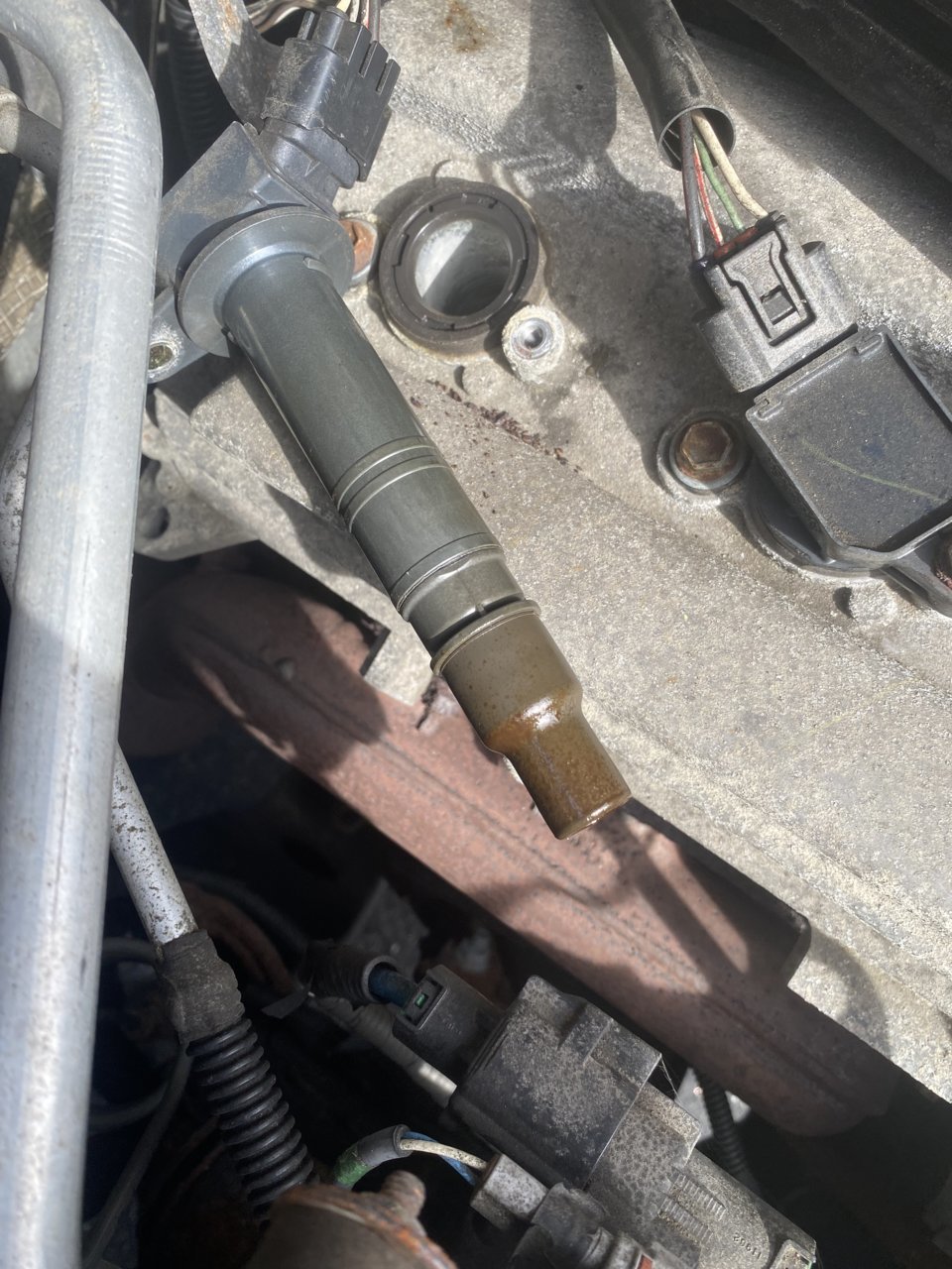

    Basically the title. I've noticed a good amount of piston slap also that seems to come and go. Give it to me straight boss. Could it be as simple as a valve cover leak? Odd that it's on all cylinders.
    120k miles 2012 trd sport DCSB
    edit: sparkplugs have been in for about 15k miles or so, and decided to switch back to OEM. Piston slap was there before spark plugs were in so it seems like I was sold a dud from the dealership.

    If the valve covers are leaking, I’d expect to see oil above the threads and on the coil boots.

    going by an old pic chart I'd go with valve cover
    your insulators look nice and white and the oil looks wet

    I wouldn't worry about that, oil on the threads isn't gona hurt anything.
    A cylinder that is burning oil will typically coke up the end of the spark plug, those look like new.

    If you've never done the valve cover gaskets, you should start there and re-evaluate. They will probably need to be done anyway, possibly spark plugs as well, which you can clean or replace

    Like this?
    Just changed my valve cover gaskets. Probably didn’t need to o the coils but I did anyway
    This occurred at 120K

    The plugs look like someone put anti seize on the threads. The porcelain looks dry on both the coil and combustion chamber side.
    I would put them back in and keep an eye on the dipstick for oil consumption.

    Those plugs look really good actually! Not fouled, so I dont think its oil in the cylinders. And like others have said, Define the "Piston Slap" youre hearing. and yep, oil is bluish smoke not white, and smells like burnt oil. ALso just curious when does this "slap" occur? Under power loads? at Idle? What octane gas are you using? So many questions, sorry!
