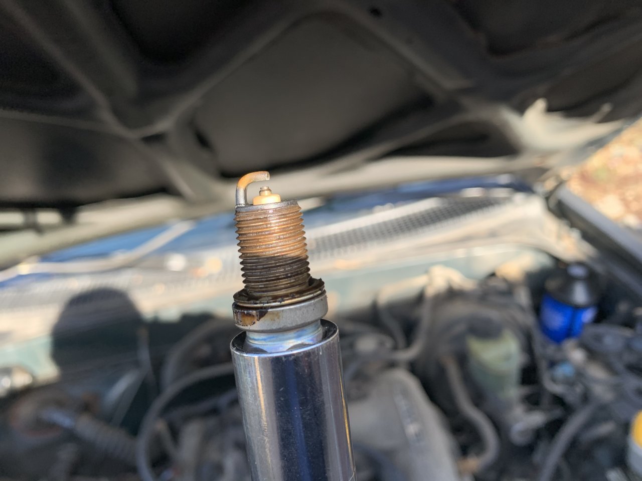

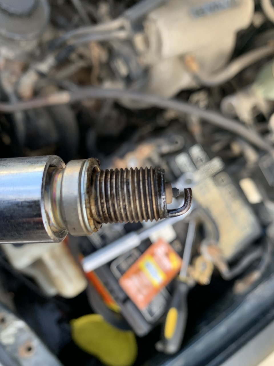

    Today I changed my spark plugs, wires, and coil packs. The engine has been a little “shaky” since I bought my 1998 Tacoma a few weeks ago. Since I didn’t know how old the plugs were, I figured I’d give it some new ignition parts and see if that helped the shake.

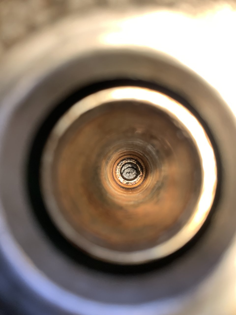

    When the plugs came out, they all had oil on the threads. While I had the plugs out, I looked down with a flashlight and every single piston head had black grime on it that looked a little wet.
    I had a bad oil leak from the valve cover gasket and the spark plug grommets were all old and hard and brittle too. Those have been replaced, and the leak seems to have stopped.
    Is it possible to get oil down past the spark plug to the piston head from a leak like that? I will say that the plugs were not particularly tight when I took them out, so I thought it was at least a possibility.
    I’m hoping that it’s not blow by from the piston rings. I’ve done about all the work that I wanna do on this truck for now!
    It seems to run better after I got the new parts in. But with all that grime on the piston head, I wonder how long it is before the new plugs are all fouled up.

    I think the pistons look okay given the view from that little pic through the hole. Used pistons typically have a black carbon coating. If it were actually wet with oil I think your plugs would be wet too (not just the threads) and you would be making some smoke for sure.

    Spark plug looks ok to me, little worn but ok

    Good point. I don’t have any blue smoke from the exhaust.

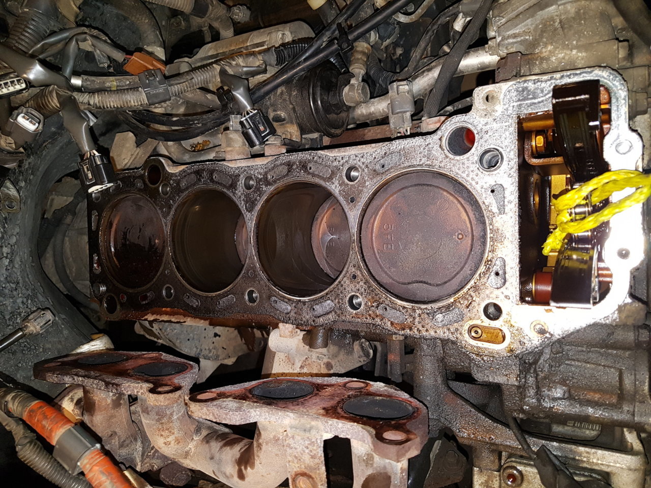

    I wouldn't worry about it unless you've got other symptoms. This is what mine looked like at 207k, and it burns no measureable oil
